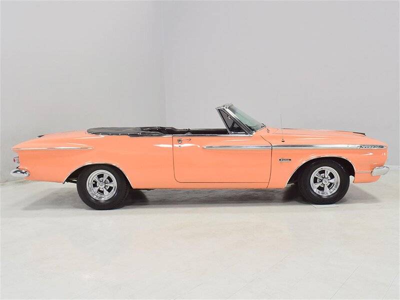

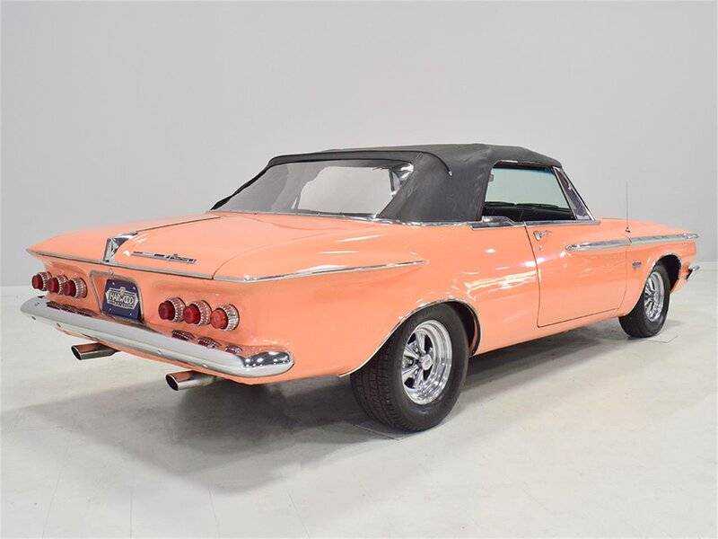

Two questions if you dont mind Curly.... if that is your car in your avatar, what color is it? and is your car a sport fury? I thought one taillight was a savoy, two was a fury or belvedere, and three a sport. Thanks.
yes..thats my car...it's a standard fury convertible..no reverse lights..i don't know if someone changed it out along the way..as far as the color it came from the factory white with a red interior..it's now black interior..it's a very old paint job..someone did a great job on it..went to a lot of trouble to get up inside everywhere..hard pressed to find even a small trace of white..it really appears to me to be a 55 Plymouth color....pompano peach..
Ive got a 62 savoy ,so i tend to notice 62s. Ive only seen one 62 in a similar color, on a 62 dodge (i think) at the drags in southern california. It was the only other 62 i ever saw at that track. I was wondering if that was an original 62 color. I really, REALLY like it!
