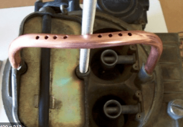

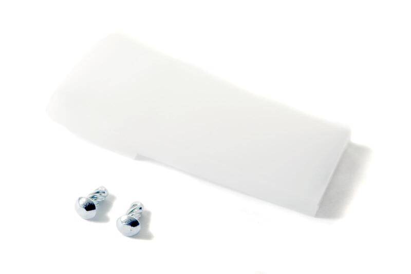

Could be fuel sloshing into the manifold. Are you running a Holley? I think Holley used to make a baffle that helped stop fuel sloshing.

Holley 26-89 - Holley Fuel Bowl Vent Baffles
( 5 )
Part Number: HLY-26-89

My car also has the check valve at the vacuum brake booster, but i am sure the fuel from the rear bowl spilled out in the intake as i had to crank quite a bit to get it running again as it flooded.
