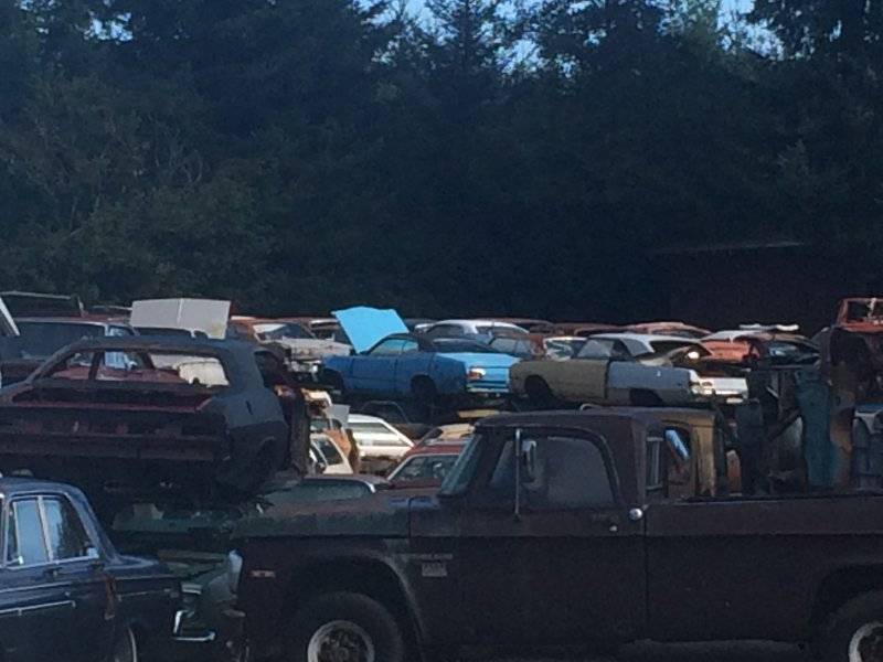

There are a few Mopar specific wrecking yards but you have to be persistent to get what you want.
Wildcat auto wrecking in Sandy, Oregon is one. I've been there. They did have some 3rd gen Charger stuff in 2017.

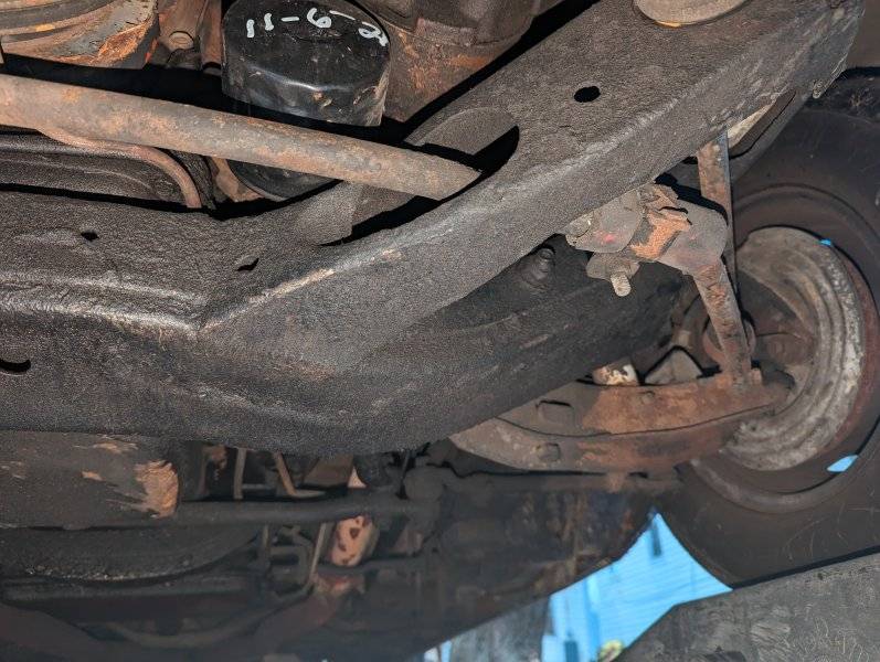

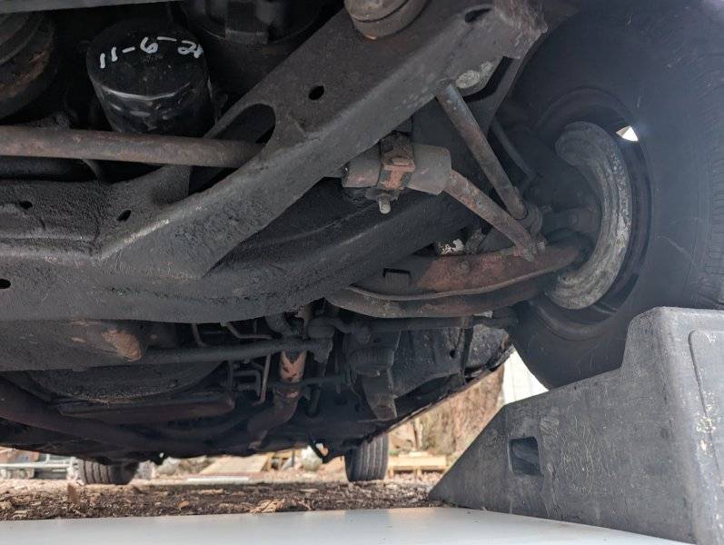

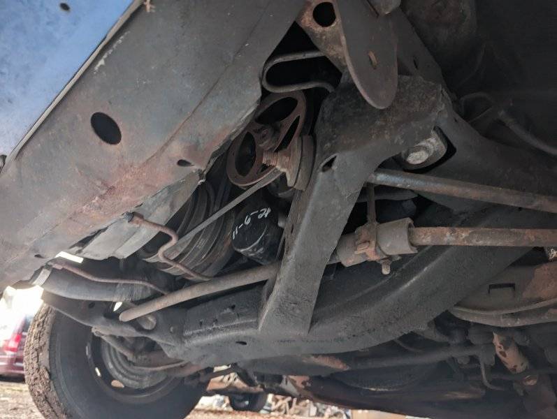

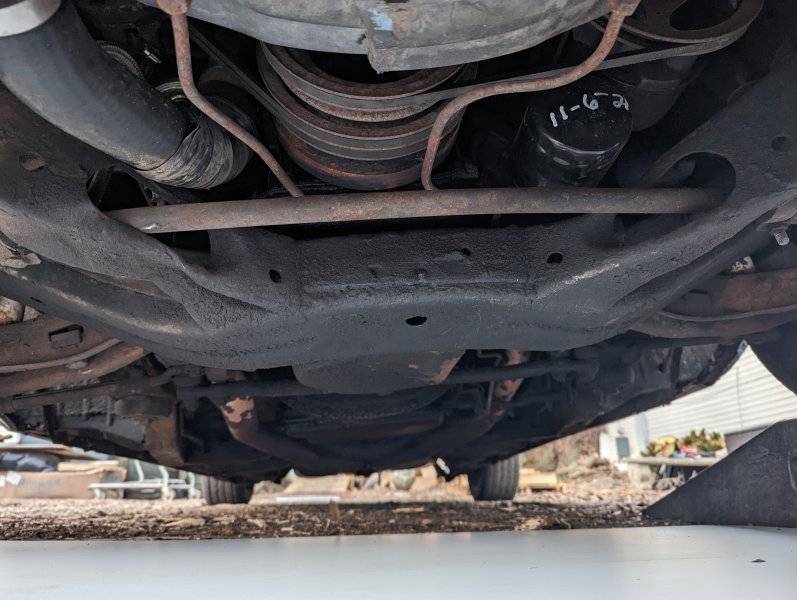

Serious apologies for the lateness of the photos. Live happens in my home more often then normal. Here are the photos I promised.

Well the passenger side looks a little funky, but I don't think that would cause it to wander, welds look about right. Not sure if it's the camera angle or not but it looks like the car leans to the passenger side, could be because of K frame.
Like QuickBpBp said, you can use a 400 B body K frame up to 78.

That lean you're observing is due to the one ramp that I used so I could get under the car and take pictures. My full ramp set was stolen during our move. Just bought a new set today.
Good to know that K-frames going up to '78 will work. I was limiting my choice by year and forgot that such items were used for multiple models and years.
I'll let y'all know what fun I find.
