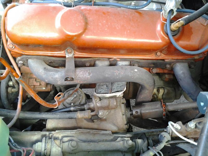

It is easier with pictures
Hedman 78030 driver side

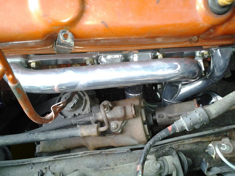

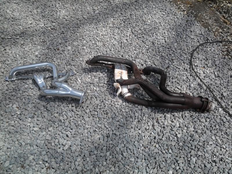

Schumacker on the left Hedman 78030 on the right
Voila!

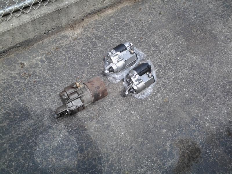

old oem starter and 2 new version
I installed the top right one a little bigger and more cranking power

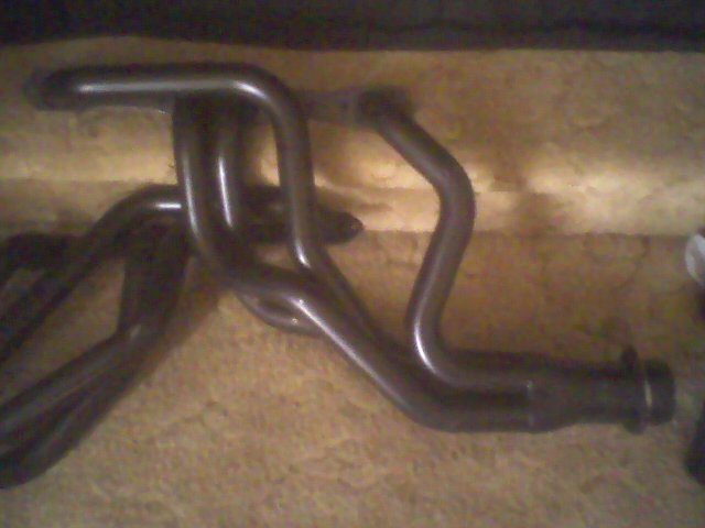

im a little confused here, you say you are using oem mounts but your car is originally a small block, did you swap the K member? i know i can get the conversion mounts but i have a set of BB engine mounts . im just going to mount the tailshaft and then cut the perches and reweld them to the K member in the right spot if i have to. here is a pic of my drivers side header. the downtubes look a little different , but it could be the angle

thanks for the pics, it looks like i can cut 3 of the tubes and rework them and then weld them back up to get around the steering box.
