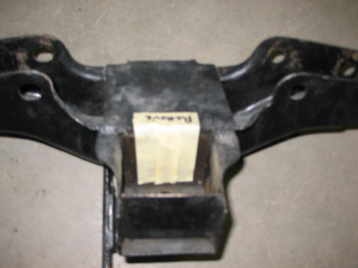

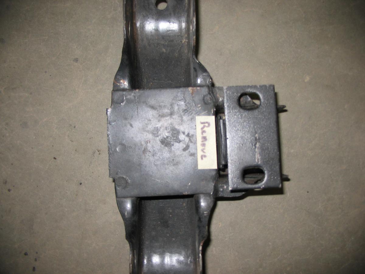

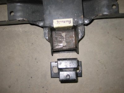

I finally got around to getting some pictures for you. The A body mount needs to be moved back about 3/4 of an inch. I`m sure this may vary from car to car. I`d recommend putting the mount in the crossmember and taking a measurement on the car first.
The bracket that is welded to the crossmember was cut with a plasma cutter but I`m sure theres other ways to accomplish this.
Once you have the notch removed there is a dish in the bottom of the bracket that should have a plate welded in so the mount sits flat.
The new mount only has one stud and it will fit into the next hole if you elongate it a bit.
Once you have the mount sitting where you want it a plate should be welded in to take up the slack at the front of the mount. I`m sure theres other ways of accomplishing this but it seemed the easiest and looks factory. Have fun and don`t think twice about putting a big block into a B body!
