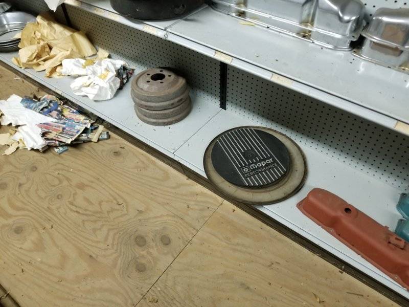

I have some old Direct Connection chrome valve covers. Driver quality. You can barely see them in the picture, but if you are interested I can get better pictures. I think they are tall enough to clear.
