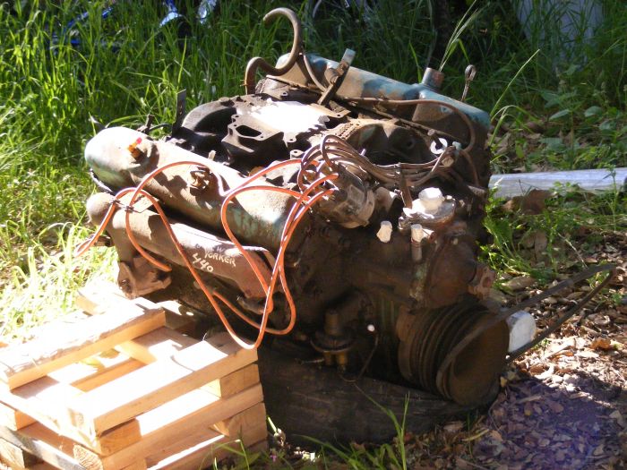

Here's some pics of the current state...still got a long way to go....but its allready come a LONG way.
