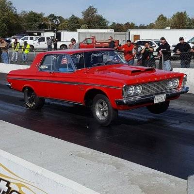

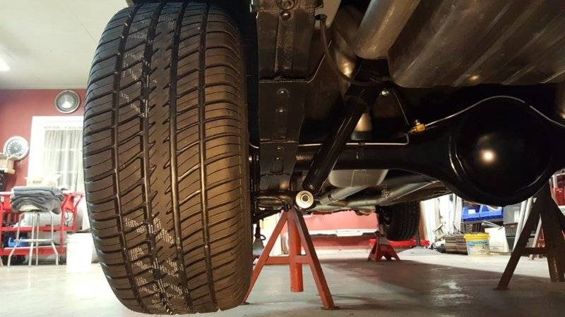

I am minitubbed and springs moved in.The rear meats for the streets is 16.5X31,slicks are 10.5 W

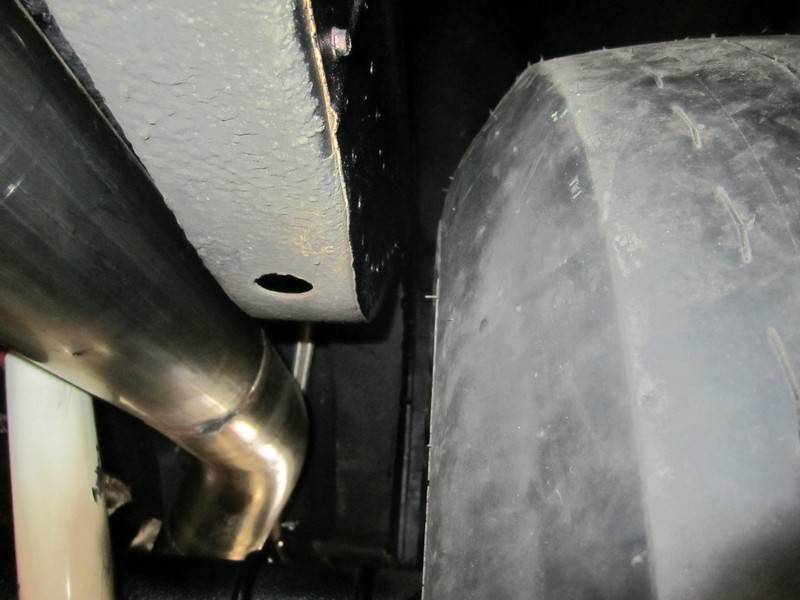

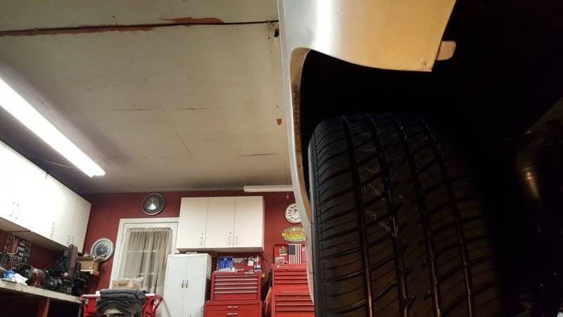

The thing that can get you in trouble is the tire bulge. Doing my measurements on my '62 all looked good until the tires were mounted, then there was a clearance issue at the springs because of the bulge.
I still have the original housing and used Dr. Diffs flanged axels to keep the "narrowest" housing. '62 and '63 are the narrowest "b" body housings.
Useing Cooper 275/60/15 the "footprint" is 9" and the "buldge" is 11" on a 8" rim.
I had bought rims with a 4-1/2" backspace and the buldge was 1/8" from the springs. Had to use a 1/4" spacer to move it out. A 4-1/4 backspace rim would have been the ticket.

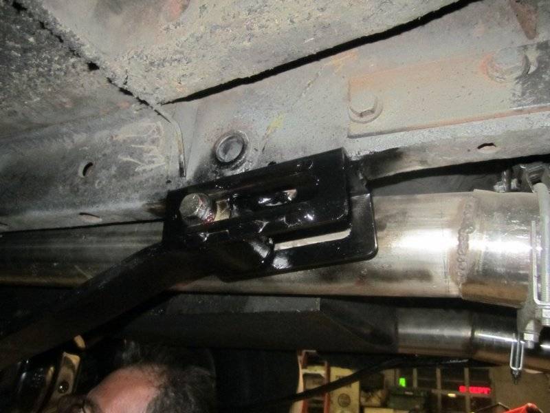

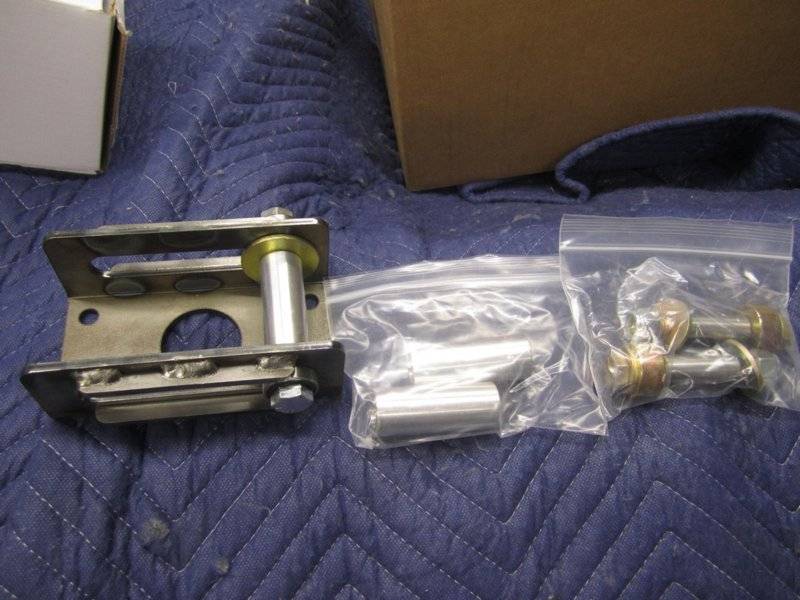

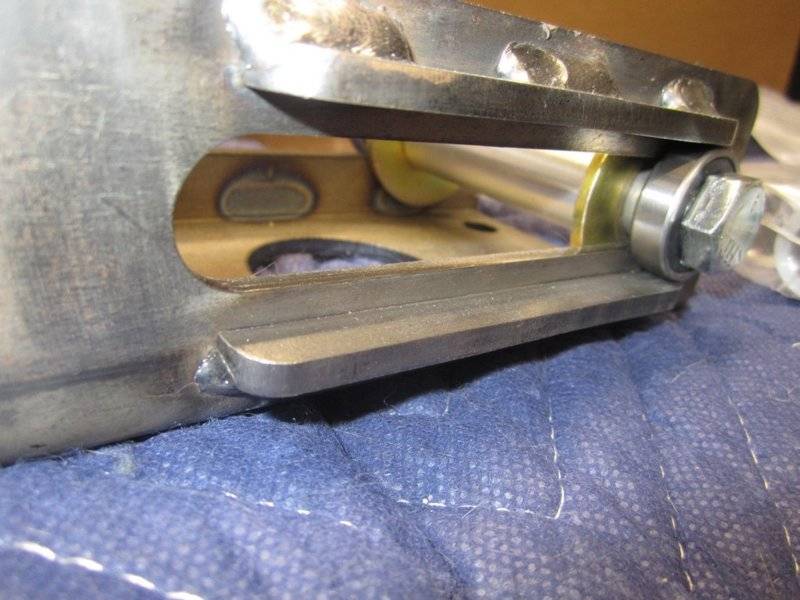

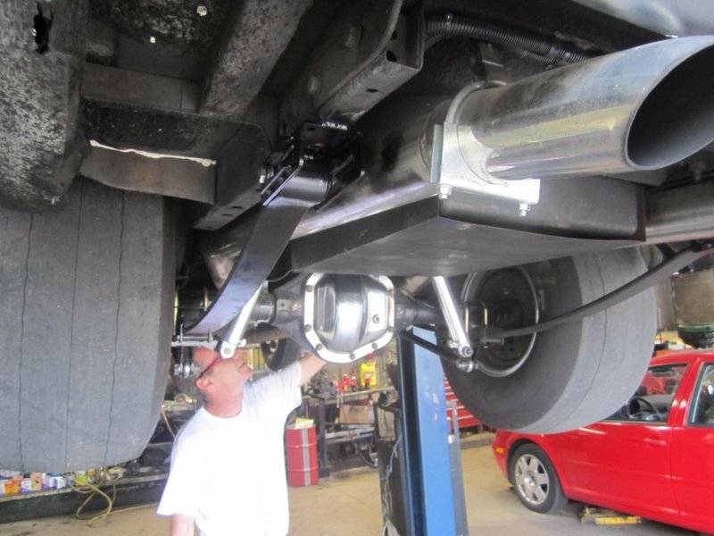

Move the front spring hanger flush to the outer frame rail. Redrill outer hanger mounting holes. Drill an access hole thru the frame for the spring eye mounting bolt. Weld the inner side of the hanger to the outer frame rail. Weld a plate to the lower rear frame rail and mount sliders from Speedway Automotive. That way with the correct offset wheel it'll all fit on a 10" rim. However we have mid 10 second cars hooking fine on 9x28. Good shocks with proper adjustment is the key either way.
Doug
I bought the Afco made in the USA sliders just because.They offer the offshore for 1/2 the price.They came with hardware for SS springs and I had to go back to Calvert to get the hardware for his spring.The bushings have different OD's. Calvert sliders are also angled and I still wonder if they are better??????

I will say I cant agree completely with you on that. I run 30 x 9 Hoosier radial slicks on my 63 and I never have any problem hooking at any event. A test & Tune or an NSS race I usually always hook fine. My car is not super fast at all as its a street car I drive to the track and race sometimes with the NSS cars. It will run 10.70's on good days. And its nothing special at all as I run just the 3400 lb SS springs and the longer extending MP shocks that have no adjustments on them. One day I ran 10.76 three passes in a row as the car is always very consisdent. I used to use a 29.5 x 10.5 tire and it fit and would be fine for a drag car only but I found on long turns like beltway ramps the tires would rub and even smoke from to much rubbing on long turns. So I went to the 9" wide tire that has plenty of room and never rubs even on turns and they hook as good as the 10.5 tire did. I found when I race as long as I stage in the grove which is the tire tracks where everyone has been launching I hook great. I don't even use a pinion snubber and its all stock suspension up front with 90/10 shocks. The tires today are so good as I see mid to low 9 second cars hooking on 9" tires. But you have to go with what you like of course. Good luck with it what ever tire you go with. Oh and of course I have stock wheelwells and the springs have never been moved. Ron
