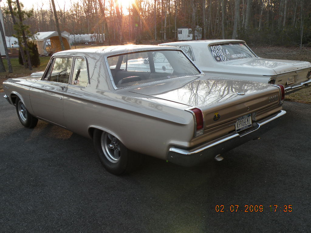

with stock spring location. i went with 15 x 8 rims with 6.5 back space. pictures later on.
heres a stock spring with a protrac tire and american racing wheel.
Is a 15 X 7 wheel okay for the 275/60. Is that the minimum width you would use for the size tire. How does the tread sit on the ground when aired up. Do you get full tread pattern on the ground is what I mean.
yes it is ok, and yes i get a full tread pattern on the ground. i have taken the tires off a few times and they fit back on the wheel just fine, not forcing the tire to fit on wheel...

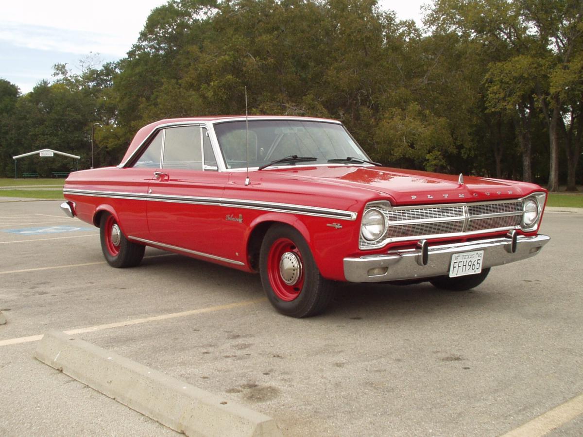

Here's a pic
Daryl (cwmoss)
15x8 w/5.5 bs

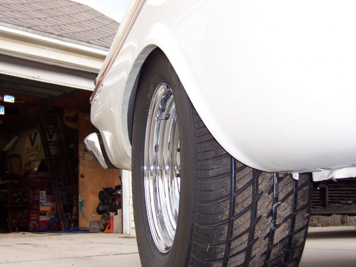

On my 65 Coronet w/inboard springs I am running a 15x8 steel rim with a 4.5 bs. I shaved the lip all the way and have just enough room to fit my 28x10.5 M/T ET Drags. They only fit because they are 28's, anything taller would rub.
With the 4.5bs this a pic of the wheel well lip. Only a 1/2" clearance.

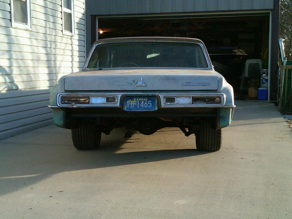

here is mine with 15x8 with 295/50/15
sorry here they are
i think there are 4.5, i like the 295/50 rather than the 275/60 but thats just my opinion, they all look good.
