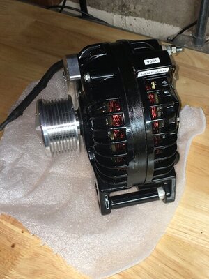

I still have a really nice black alternator with an aluminum 8 groove pulley from CVF already attached. Alternator is the Tuff Stuff model 100amp model. It requires an external regulator.
This sounds like what you might need/want. PM

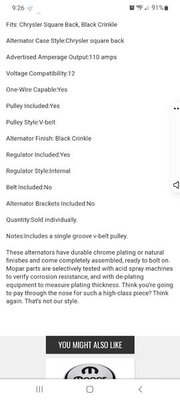

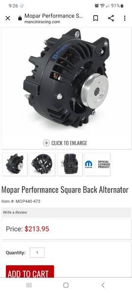

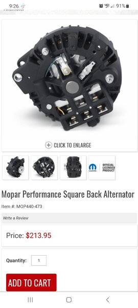

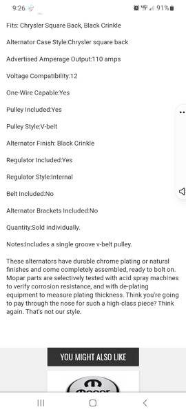

Was thinking about this one. On the the description it says one wire capability what's that mean. Figured it's one way or the other. Also would I be able to just have my 8 rib serpentine pulley pushed on.
Screenshot_20220218-092615_Chrome.jpg Screenshot_20220218-092630_Chrome.jpg Screenshot_20220218-092637_Chrome.jpg

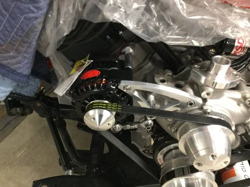

Out of curiosity, what was the advantage of switching to the new belt drive arrangement (not a true serpentine system where one belt dtives all accessories) vs the origional belt drive arrangement? It appears that the alternator sheave is larger diameter than stock and the crankshaft sheave is smaller diameter than stock. Wouldn't that result in lower alternator RPMs and corresponding lower output voltage and current, especially at idle? If so, then, the new alternator will likely NOT live up to your expectations or requirements. Is the physical color of the alternator a requirement? Just trying to understand your issues.....
