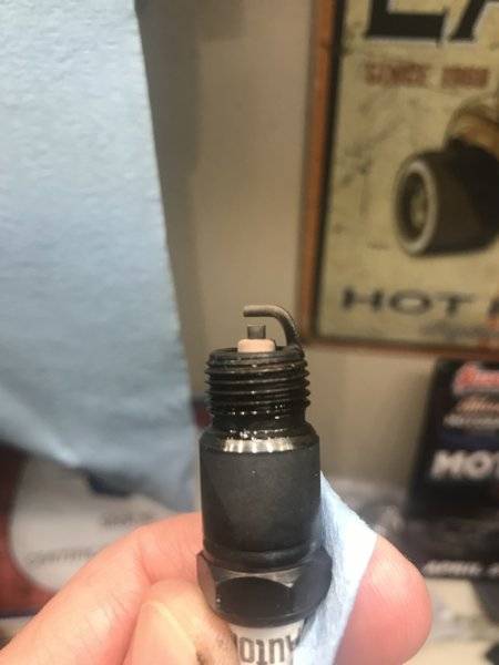

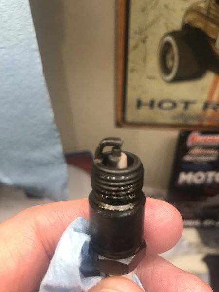

I recently replaced my 25 spark plugs with cooler 23s to eliminate spark knock. Helped some, but I have these isolated black spots after driving 500 miles. What causes that?
440 with .5 lift cam, Keith Black raised pistons, MSD ready to run dizzy, rpm air gap and Brawler 650 carb, vac advance on.
View attachment 758959 View attachment 758960 I recently replaced my 25 spark plugs with cooler 23s to eliminate spark knock. Helped some, but I have these isolated black spots after driving 500 miles. What causes that?
First I'd like to know what your original (hotter) plugs looked like? If they were burning clean all around, and if you've made no other changes, then what I'm thinking is changing to cooler plugs has exposed a basic weakness in your engine combo. What I mean by that is a hotter plug may have been just enough to mask an overly rich condition or an inefficient burn. Did the engine run fine before? What is your compression ratio and cam specs other than lift? I'm not familiar with the ready to run MSD distributors other than I know they don't need a stand-alone control box, but if they produce a hot spark like say the 6A does and your plugs wires are good (no misfiring), I don't think your ignition system is at fault. What were the conditions as to when the engine would knock? What's your base timing, mechanical advance curve, and total timing? What octane fuel are you using? May be premature to suggest this, but perhaps a better timing curve may be the better remedy?

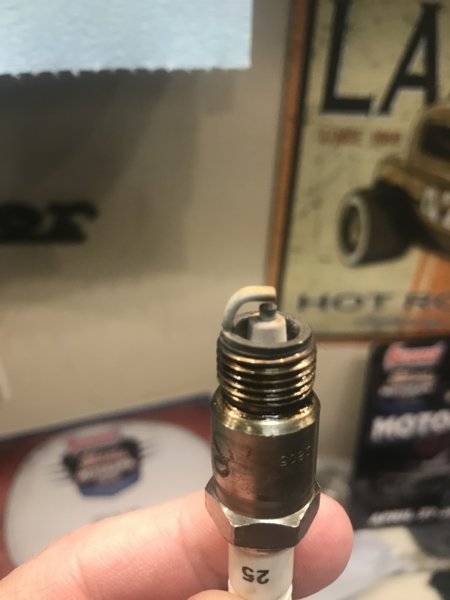

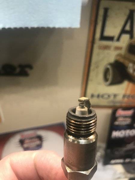

Here are the hotter 25s. They look better but have a brown spot not black.

Perhaps it's just the picture, but the gap looks small on the half black plug.

dirty burn. what heads? I always go thru this with iron heads.
