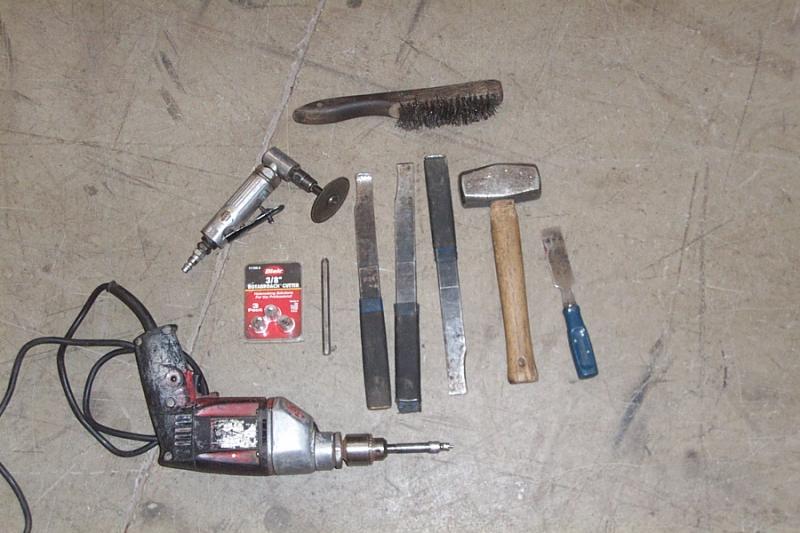

Can your China ones drill over 2000 welds without breaking?
These are the only ones that I'll use.

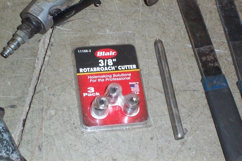

It is about the money with me. I drill over 20000 welds a year, every year. The Rotabroach cost 3 times as much as the hole saw style but they last 10 times longer. I used the hole saw type for a couples years because they cost less. I finally tried the Rotabroach and my frist thought was " what took me so long?" They cut faster, easier and last sooo much longer.
I actually drilled out 1 and a half cars with one bit. About 7500 welds.
