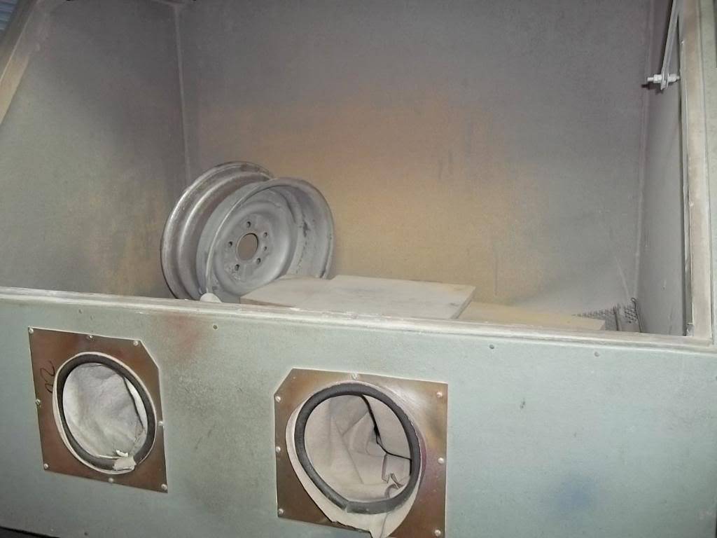

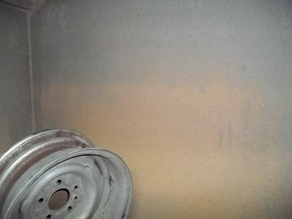

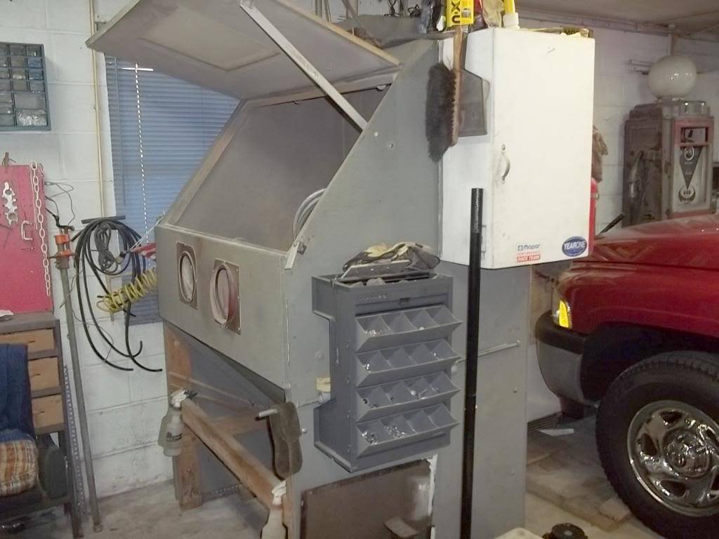

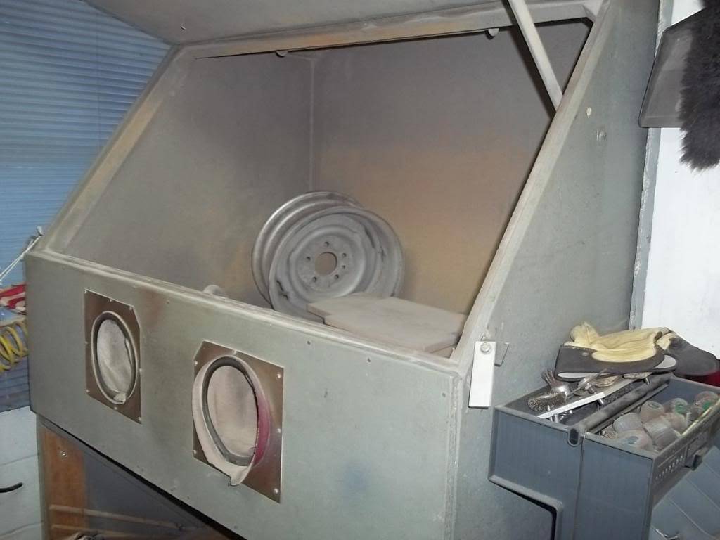

Here are some pics. I painted this thing when I built it. You can see some paint has been blasted off and it has a little pitting. It still amazes me that it held up so well.

Nice job on that cabinet, great size! Makes me want to sell mine and build myself one just like it.

How long does it take to blast a wheel?
A typical painted steel wheel with some rust spots will take at least a couple of hours. If the sand is new and sharp, maybe a little less. That's one of the reasons I'd like to find a different media. Re-using sand can reduce the efficiency quickly. We have a lot of sand pits around here and I've always been able to get it cheap but it's getting harder and harder. The wheel in the pic is an old chrome reverse. Blasting a chromed wheel takes a bit more dedication.
