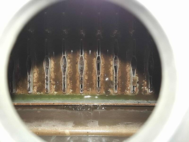

Well, I got tired of chasing the heating problem with my 383 RR so I bought a new Griffin direct fit radiator with elect fan. It worked great for about 30 minutes then I started having the same heating problem again at low speed and idle.
OK, so I found out what was causing the problem and here it is:
crap, I can't find the pic right now, I'll post it shortly. Anyway the problem is the radiator clogged with rusty dark looking debris, looks like small gravel but it's metal.
It's obviously from the block. What is the best way to flush the hell out of it?
That's what I found when I drained the coolant and looked inside my BRAND NEW expensive aluminum radiator. Not a happy camper to say the least. Never noticed much of anything in the coolant when I drained the radiator on other occasions. I guess the radiator cores filtered it all out, :/

Judging from the pictures, looks like there is a lot of junk in that cooling system. I always pop all the freeze plugs out take a pick and break up as much crap as possible then do a high pressure water treatment to loosen and flush as much out as possible.

It looks like stop leak in there. You will need some chemicals to flush that crap outta' there. Hoe you can find something that plays well with the aluminum. I bet I spent 3 or 4 hours flushing out my block on the engine stand with all the plugs out. They didn't do a very good job shaking out the foundry sand from the water jackets.
BTW Your easiest way to hopefully flush the debris from the radiator is to pull it & back flush it by forcing a large volume of water through the lower hose connection.... A garden hose is marginal, a 1" or larger connection is better...
If the frost plugs haven't been changed in awhile they might be really thin looking at the scale caught it your radiator. So replacing with new ones might be a good thing in the long run.
Remove the radiator, turn it upside down and flush with water to remove the scale.
