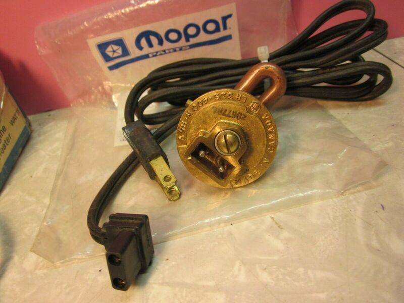

I have been using an electric magnetic heater on the bottom of my 440 oil pan for several years during winter storage, but they never last more than 2 years. I am considering another type of heater like the one pictured below. MY questions are where is it installed on the engine & where can I get one if still available? It is pictured below. It is an LR336 400 watt 115 volt unit. If I recall. I believe Hallifaxhops or someone else sells them or at least used to.

They go in a frost plug hole on the side of the block. The question is why are you using a heater "during winter storage".

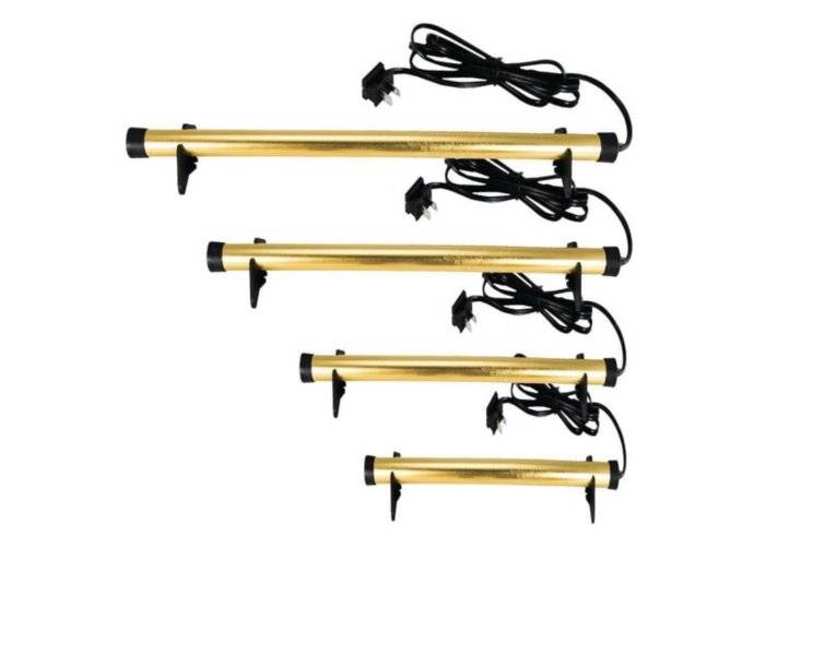

If you’re trying to keep condensation at bay, you could look into using Golden Rods, they come in varying wattages and last a very long time. I‘ve used them on boats to keep blocks and pumps from freezing.
