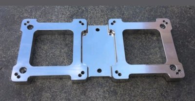

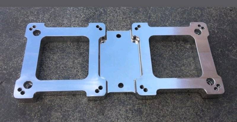

It could be done, you would have to make an adapter plate to sit on top of the super charger.
Similar to this just for six pack.

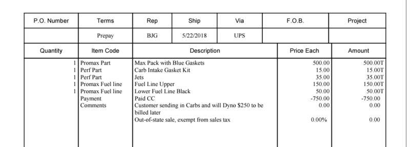

I'm telling you, if that system would have been available a week earlier, I would likely have gone that route instead of spending close to $1k with Promax.

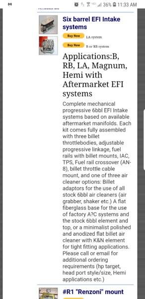

Here is the parts list from Promax.
Basically everything they make for the Holley 6 bbl system.

Once labor and dyno mule time is added, I will be at/past $1,000.
Now almost EVERY post or review I have read on Promax modded 6 bbl Mopar setups has been outstanding, and although I believe I will reap some benefits to my cammed up 440, I am certain that the stroker motor will require the mods and tuning capabilities that have been added.
With 2 weeks to go until Crusin the Coast, I hope Promax ships soon! Should be this week....

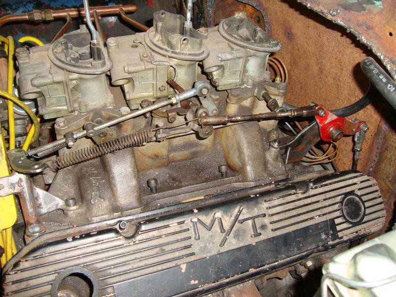

a 6pck atop a blower would be a all three carbs at once or would need progressive mechanical linkage like i did on the 6pck . did a a set of ford tri holleys on a 383 . those carbs are non vac style . so i did a progressive linkage much like this on those .
a 6pck atop a blower would be a all three carbs at once or would need progressive mechanical linkage like i did on the 6pck . did a a set of ford tri holleys on a 383 . those carbs are non vac style . so i did a progressive linkage much like this on those .View attachment 655257

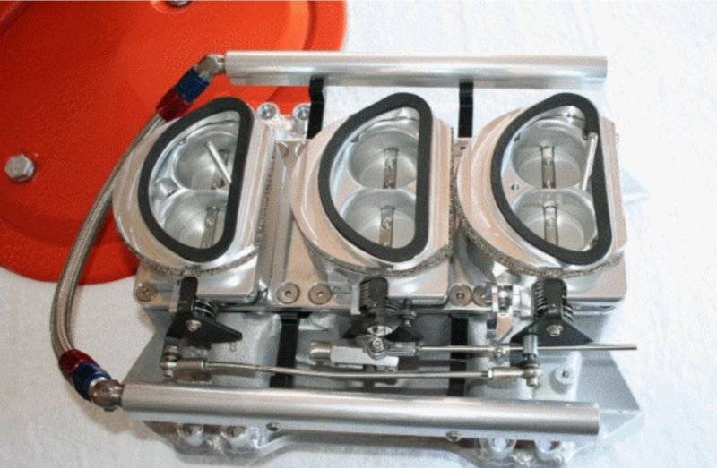

This is the mechanical and performance work of art by F&B.
Costs around $2,600 (may be less with you supplying the 6bbl intake manifold) and then you have to add a control system to it.
