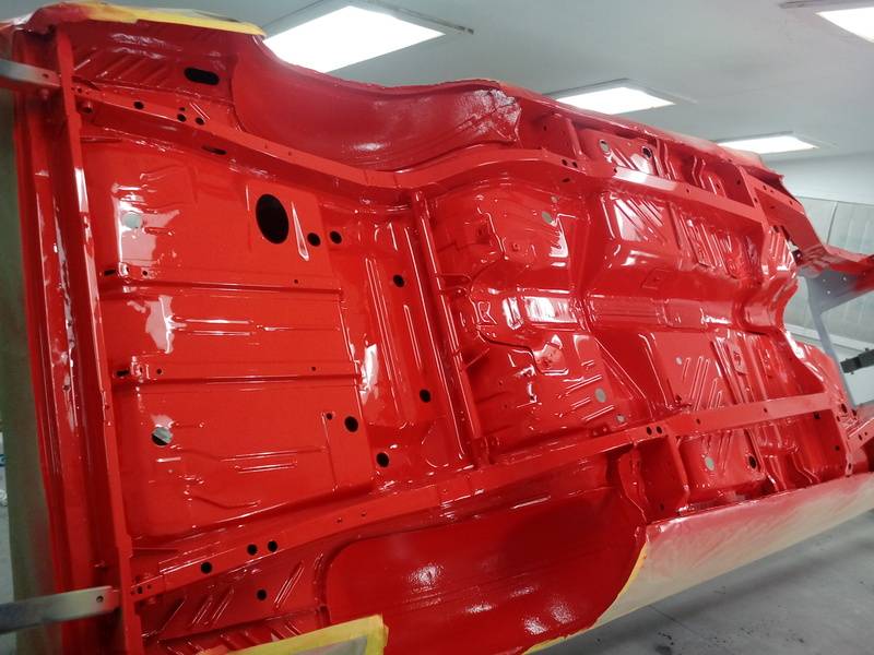

What I did was epoxied everything then sprayed a textured 2 part bedliner in. The bedliner helps with the harmonic vibrations (noise) and won't scratch off easily like paint making it a great undercoating or floor finish. Also the texture hides little blemishes as well.

original pans here, with multiple repairs
I suggest a "rust converter" (not "rust remover") Epoxy will do a better job for sure to use as your "bondo", but a pain to sand (very tough). .
Use Southern Polyurethane Epoxy Primer. It sands very very easily. I used it more than the high build normal primer as a guide coat (goes on with a sheen so when you sand you can see the low spots)

i dont have a jig like yours so i have to do it on my hoist
