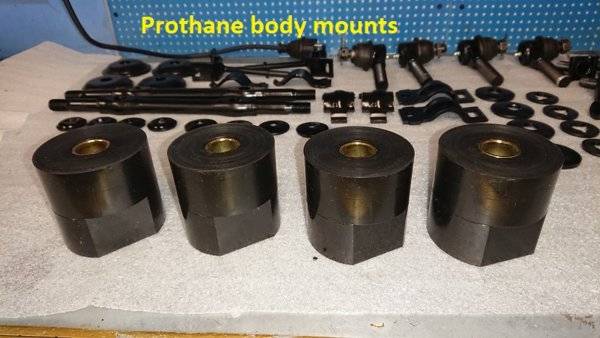

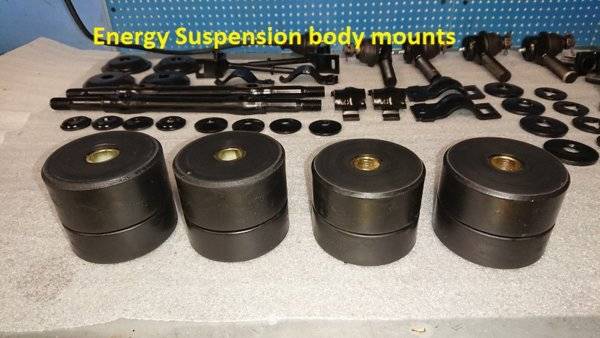

The body mounts on my 1978 Cordoba are in bad condition, so i am going to put in some new ones in polyurethane.
I have looked at both Prothane #4-101 and Energy Suspension #5.4111 but i noticed a thing that confuses me a little bit.
In the Prothane kit, the four upper mounts that goes between the k-member and the body are all the same, all four mounts have the same thickness, but in the Energy Suspension kit, there is two different upper mounts, the rear mounts are about 1/4 of an inch taller than the front mounts.
Both kits should fit my car, but why does all four Prothane upper mounts have the same height, and the Energy Suspension have different rear mount and front mount heights, does anybody know?
The energy ones crush more so they make up the difference in height

I took some measurements of the body mounts, and i see that all four Prothane upper mounts are 1,44 inches thick, and the Energy upper mounts are 1,5 inches thick (rear mounts) and 1,25 inches thick (front mounts).
If i put on the Energy mounts, the front of the k-member will be 1/4 of an inch closer to the body than with the Prothane mounts.
Would this 1/4 of an inch in height difference have anything to say, would it affect anything like engine mounts and steering shaft?
What would be the most correct body mount kit to use?
If you look closely, you can see the height difference in the pictures (sorry for the bad pictures).

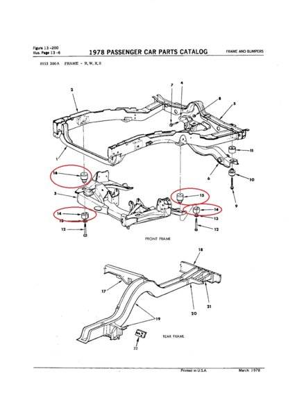

I did some research today to find out more about the body mounts.
The first thing i did was to take a closer look at the old rubber mounts to see if there was a difference in height between the front and rear upper mounts.
It was very hard to see if there is a difference because the old mounts are in a very bad condition and they have been compressed for a long time.

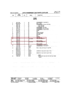

I then took a look in my 1978 parts book, and this is what i found out.
All the Cordobas (S), Chargers (X), Furys (R), and Monacos (W) shares the same k-member.
The body styles 23 (2-door hardtop), 41 (4-door sedan), 45 (2-seat station wagon) and 46 (3-seat station wagon) have all different part numbers on the front upper mounts and the rear upper mounts, while body style 22 (2-door special coupe), which is a Chrysler Cordoba, have the same part numbers on all upper mounts.
My conclusion is, please correct me if you think i'm wrong, that all four upper mounts on the Chrysler Cordoba are the same/same height since they all have the same part numbers, and the other cars/body styles have different front/rear mounts since they all have different part numbers, but i do not know if the different part numbers are related to different height on the front/rear mounts.
But anyway, it seems like it doesn't have anything to say what body mount kit you use, Prothane or Energy Suspension.
