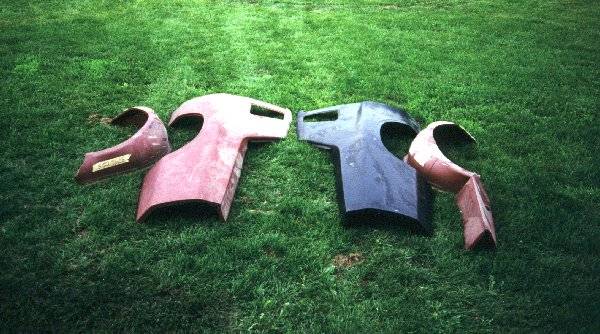

At one time, you could get "1/8th" panels from JCWhipme. There were 1/2 a qtr panel, about halfway down the panel to the bottom. Actually not a bad piece. I have a set, I think I paid $100/side. One might contact them to see if by chance they'd have them around someplace.
