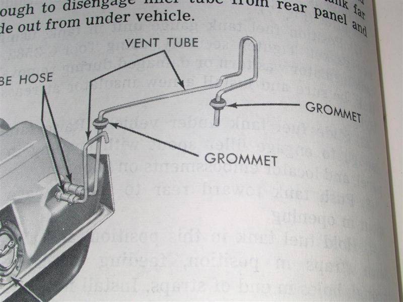

The vents on your tank actually do sort of "go nowhere" - they're exposed to atmosphere,
hence why they're vents. They ought to look like this:
Notice the grommets on the longer one - those are for where that vent passes up into the trunk, then
back down out of it.
I even have a vented gas cap on mine, even though I suppose it's not necessary.

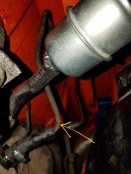

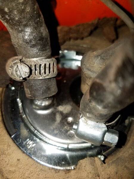

Never had gas coming from it. However, my vent tube comes FROM the sending unit assembly! Only 1 other line coming from LH side of tank. Runs up into trunk. I had to clamp off the vent to stop the leak. Nothing seemingly coming from filler neck OR lock ring. All from this tube. I DID have 105 Octane race gas in it for a while. Always run Non-Ethanol. Tricky place to get into without a lift!
Well that explains fuel everywhere, that is NOT boiling, it's just leaking. Who put the sender in and why did they hook a vent line to what is supposed to be the return line port on the sender. That and even being installed in the wrong place looks like they left a clamp off the joiner hose..
