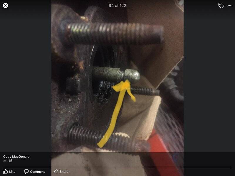

Anyone know of a source for Midland Ross 1967 era power brake booster parts? I need the adjustment screw that sets the clearance between the MC and the booster.
Good idea, but I’m having trouble finding an acorn nut with the right thread.Could you weld an acorn nut onto a stud/all thread?

Looks like I can buy Midland rebuild kits but the adjustment screw is not included. They also have a rebuilt unit for $245 but I’m not quit there yet. I book marked this site. Thanks.Might want to have a look here..
