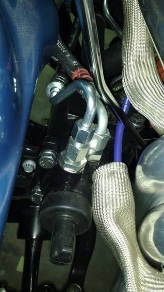

Could you post a pic? And are you running headers?

Lots of clearance with headers!
Post 1139
This is a 69 GTX 2" header tubes I have a min. 1" clearance everywhere. No dinging header tubes.

Awesome pic @69 GTX, i think i will have plenty of room and was definitely curious about psi requirement and if I would need a regulator, I still need to call March and see what those pumps are rated for...
