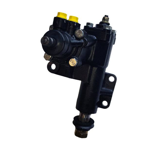

Borgeson Mopar 800127 technical information.
Steering Ratio: 14:1 (3.5 Turns Lock-to-Lock).
Input Shaft: 11/16"(17MM)-36 Spline.
Pitman Shaft: 1-1/4" Mopar with 32 Splines and 4 Master Splines, 7/8"-14 Thread.
Pressure Port: 16mm X 1.5 Flare (Located Closest to Engine).
Return Port: 16mm X 1.5 Flare (Located Closest to Input shaft).
Maximum Pressure: 1450 PSI Maximum Operating Pressure, 1100-1250 Optimal.
Flow Rate: 2.0-2.5 GPM Flow Rate Recommended.
Degrees of Rotation: +/-45.5 Each Direction of Center.
Maximum Front End Weight: 2,645 Pounds
Maximum Output Torque: 633 Ft. Lbs.
Operating Temperature Range: -40F to 248F (Big Block Applications Will Require a Cooler).
Weight: 26.46 Pounds.
MSRP: $629.00
Installation Drawing: http://borgeson.com/imageCD/800126_800127_Drawing.pdf
