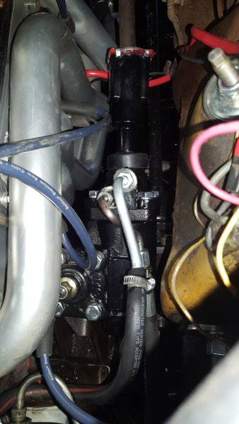

I bought the kit from Bergman auto craft, installed on my 71 383 Road Runner over a year ago. Everything fit perfectly, and makes the car much nicer to drive.
I appreciate the reply. Did you use Borgesons PS pump they sell? And are you running the Bergman coupler? How was the angle for steering shaft install?
I bought everything from Bergmans. I had issues mostly due to the engine placement in my 64. Looking at later pics, that shouldn't be an issue. The pump was a Saginaw. Fit my brackets fine. Bolt on pulley was no issue. The box needed shims to alogn it properly. Just a couple washers on one side. There's 2 different high pressure fittings. I reccomend the larger, to get more flow to the box. The coupler worked great. Bergman's helped me get mine sorted out.
