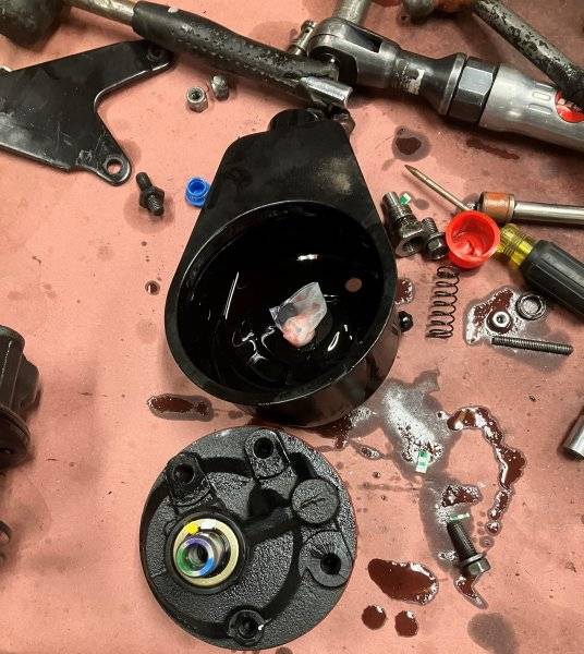

This rebuilt pump I bought had a reservoir housing with a nylon mesh screen inside. It was just inside of the return line nipple. I'm not sure of another way to implement a filter. Of all the pumps that I've used in the past, I don't think that I've used an external filter before.
