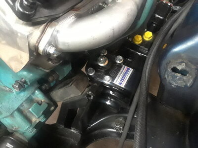

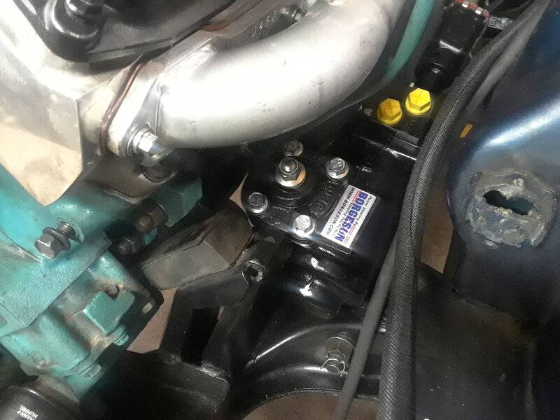

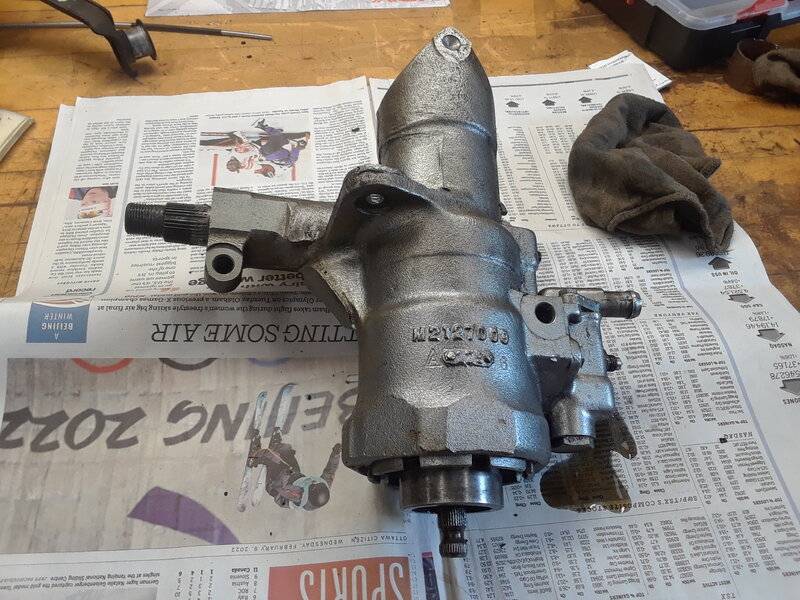

I just completed a Borgeson install with a Bergman Auto Craft steering coupler on my 64 Polara. There was no need to cut the steering shaft. I have yet to test drive, but that should happen in the next couple of weeks. The install was straight forward. The pic of the steering box on the bench is my old unit.

Looks nice man. I have the Borgeson steering coupler on the way..thinking I should get the Bergman idk..

I put the Borgeson unit in my car. Bought the kit from Bergman Autocraft. It’s night and day from my old oe unit. Mr Bergman was very helpful and quick to answer a couple questions I had. His kit has the coupler which allows you not to cut the column. Money well spent. Drives great !

I had the car out this week for a short ride - about 5 miles. Steering is way tighter and much more responsive. The bigger test will be next week when I need to drive to the alignment shop. It's about 30 miles from my place - bringing it to an "old school" guy - he's probably older than me, and I'm 68. Lot's of shops closer, but this fellow has been recommended by many classic car guys. My outing last week was deliberately short because I'm not 100% sure of my home alignment. First one I've ever done. When my car returns from the alignment shop, I'll compare his settings to mine. The drive home should give me a good indication of how improved (hopefully) over stock, my new system is. I'll let you know how it went.
Well, I’m still sold on the Borgeson from Bergman Autocraft. I drove about 30 miles on the interstate last Saturday to a show, 75 mph. Felt very good, safe, no need to constantly move the wheel like my old box. On the return trip I was late for a concert my grandson was in … 85 and up to 90 on same interstate. All great. Before the install I had replaced upper a arms with qa1, new rod ends, solid steel rod connectors, strut rod bushings, and welded braces on the bottom of the lower a arms. Bilstein shock all around.Next step is a bigger front sway bar and & adding a rear bar.
