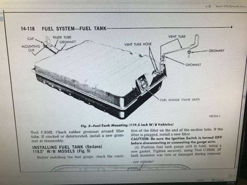

I am installing a fuel filter that has the 1/4” vapor breaker nipple that runs to the fuel tank. I am also replacing the 2 old fuel tank vent lines and it got me thinking?? Are both those vents needed? See where I’m headed with this?
I lieu of dropping the tank and replacing my “recently” new single port fuel sender with a dual port sender/return, can I use one of the vent lines (the short one) instead? I realize it’s no longer a vent if I do. Could always add a vented cap for redundancy?
Yes I’m being lazy.
No. If the factory had intended for it to work that way, then they would have done it. The two vents serve two functions, and should remain. The short tube looks to be an overfill relief, and the longer tube for a vent. The length is specific so that fluid doesn't escape, and I am willing to assume the inner tube is long and goes to the rear (fill tube side) of the tank. Do it properly, and get the return tube pickup...

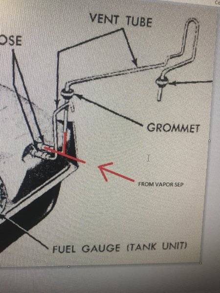

I “could” add a T into the bottom of the long vent line at the tank nipple and still have both vents. That’s all the vapor separator is -another vent technically to relieve pressure. It’s not a return line.
I don’t disagree with you, but the physics behind it would work (see my sketch below). I think the tank vent nipples are smaller than the 1/4” vapor line so it doesn’t match up anyway.
The vapour separator is the pressure side of the fuel pump so sorry it will have raw fuel in that line returning to the tank. I would connect it to the sender return tube the way it was designed.
