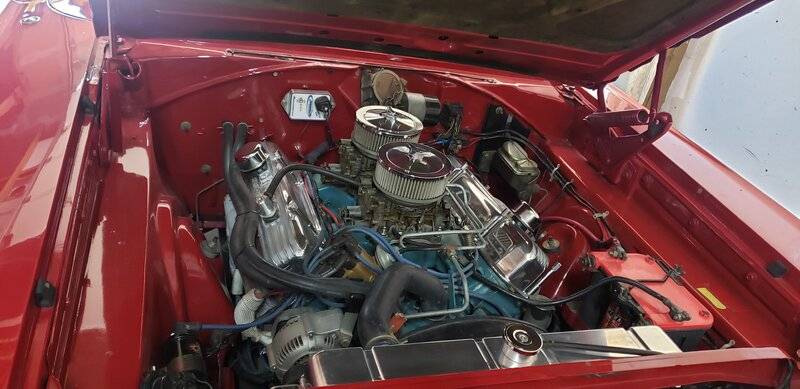

My twin 500s have blocked offs where I believe I could add bowl vents, has anyone tried tried this?
I do have some vapor lock on super hot days so trying to do what I can.
Right center top of carb is where I am thinking it should go maybe with some tubes off a couple junk later carbs?

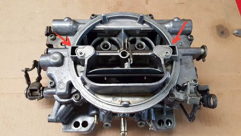

Your bowls are already venting. Adding an external vent will do nothing.
Just a thought. How thick are your base gaskets? I used to have a similar issue until I went with a 9266 Eddy insulator.
I put put the moroso ones, that are two gaskets sandwiching a aluminum plate. I imagine they do help some. Many moons agoI had "1 inch plates but it ran bad so I didn't want to retune so I took them out.
Can you explain where they are vented, I am eager to learn. I bought these carbs new back in 1982 and love them. Just trying to improve where I can for the heat I recently moved to.
the vent holes are next to the step-up spring/piston covers on top of the carbs. using a return line off the carbs will end vapor lock; providing that the fuel pump is up to spec. adding another vent will do nothing for vapor lock.

What happened to the old heat shield. It got thrown away because every time went to work on the motor it was in the way. Well had to make one and put on a 440 With two holey double pumper's and that solved the problem. Maybe rap your inlet tubes with fiber glass spark plug rap's. It might not look cool but may solve the problem with fuel getting too hot.

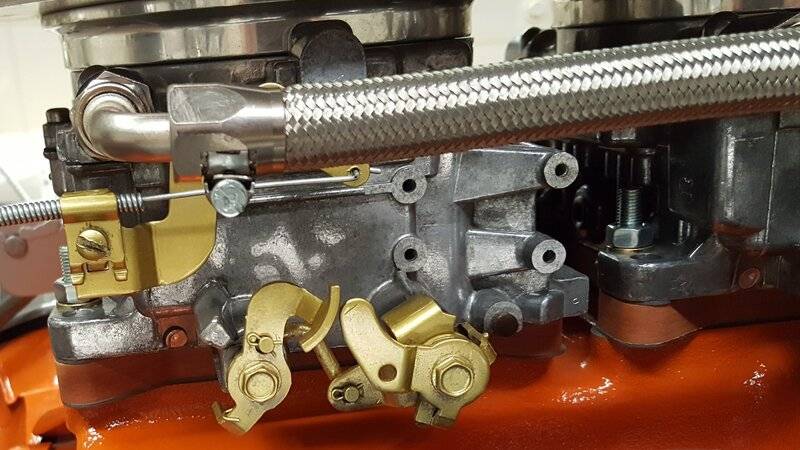

Yes, if you look close in pic i tried some thermal wrap near heater hoses but not all the way.
Maybe wrap the whole thing?
