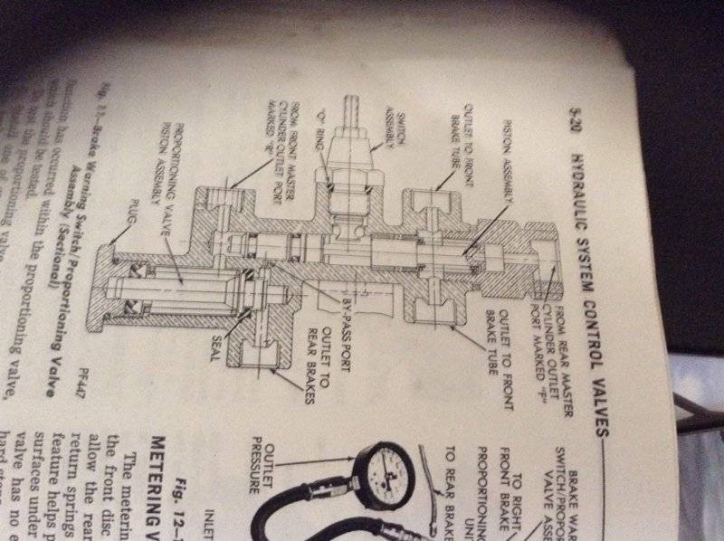

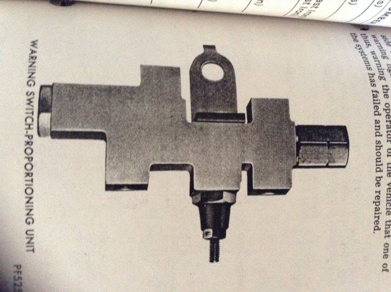

Hi, I see you have replaced your valve with an OEM porportioning valve, yes? I have maybe some help with pictures.
If you have shifted the piston over enough to close the rear brake line you will need to remove switch and carefully use a tool to start the piston to shift back into place
Be careful not to mar threads or seat for oring
This is a safety to lock one system out if you have a brake failure
