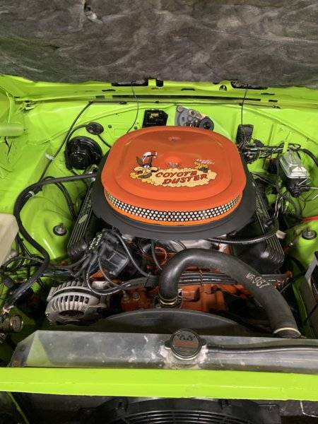

I have a 1970 Belvedere that originally was a 318 car with 4 wheel drum brakes. I’ve upgraded to disc/drums and want to add a brake booster. Current mc uses a single straight rod bolted to the brake pedal and I have 15” of vacuum at idle. I’d prefer the single diaphragm over the double ones.
Any purchase recommendations appreciated!
I already have the mc plate on the firewall see photo.
