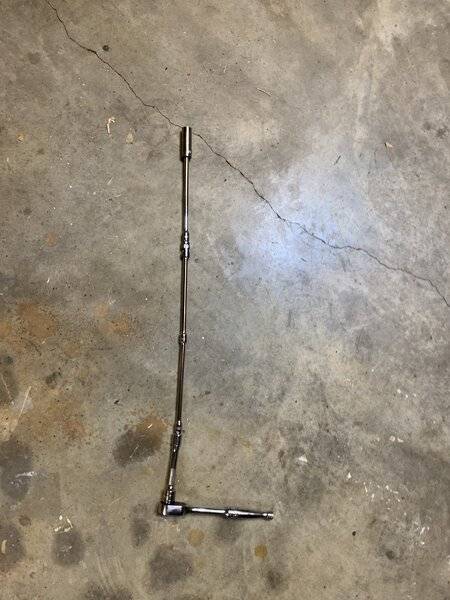

I've seen this issue pop up several times for folks wanting to swap out a booster or to upgrade to a disc system. The upper right bolt is too close to the brake pedal mount to effectively get a deep socket, and a universal joint on it.
Solution: Take a 1/2 deep socket (1/4 in drive) and place on the nut by hand....you may have to unbolt the left windshield washer arm cotter pin and lift it up, now down....then feed a 1/4 socket extender through the bracket into the socket. you then can add an adapter to the female end and go nuts on the sum'bitch. I got mine off and it was a salty bugger. I'll attach a pic of the rig I used.

well this way you just need to lower the column and straight to it
