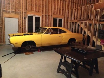

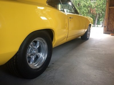

Will I need an alignment after replacing idler arm? I seem to have a positive camber now that car is off jack stands. Not sure why? I can take a pic tomorrow morning.
Thanks
No need for an alignment.
I'd bounce the front end before pic to settle suspension. If idler is same as the one you took off shouldn't change anything, IMO. If it's a longer or short I think it would affect the toe in or toe out, IMO.
Ok. I'll try that. I did notice that the shocks should be down about and inch. Maybe I'll take it for a quick drive.
Thanks for the advice. Car is sitting great now. I'll add a few pics tomorrow.
Cheers
