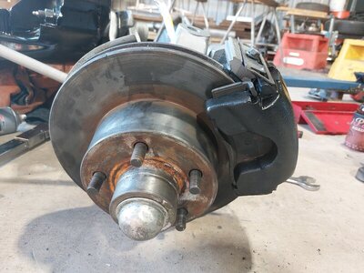

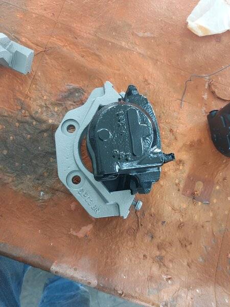

Can someone please tell me what type of brakes these are and what year. The car they are in now Is a 69 coronet. Don't believe rhey are original. Looking to get new seals and pads and would like to order the correct stuff.

They are slider style off a later model Mopar. Do some more research to find years and models.
Mike
Chrysler 1973 up used on A,B,F and many of the 80's Body styles rear wheel drive cars.
When buying replacement parts I just use a 88 Dodge Diplomat as a reference .
Yes everything I see points to mid 70’s. Rotor, caliper, etc.
I use 1975 Dodge Dart for replacement parts.
Original disc brakes for 66-69 Coronet was 4 piston caliper Bendix brakes with thin rotors, those are not them.
Unless you just threw things together to test fit swap the calipers side to side. The bleeder screw is at the bottom of the cylinder in one view.
W/O digging thru my stock of calipers there were two castings that differed where the inlet was in relation to the bleeder screw.

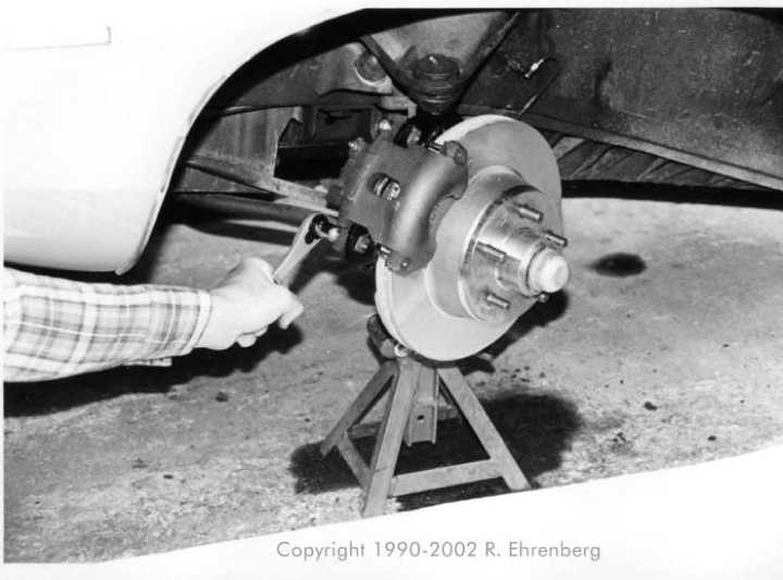

Spindles may have been installed on the wrong sides as the calipers are supposed to be mounted to the front of the spindle not the rear.

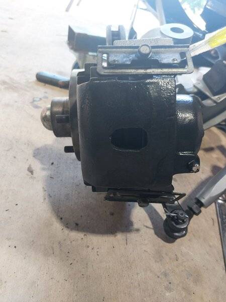

In the assembled photo your bleeder is on the bottom. I had the same problem on my car. To bleed I take the caliper off, put a block of wood between the pads, and rotate the caliper so bleeder is on top, then bleed them, and install it back again. It works just fine. The bleeder position is only important when bleeding, not for operation.

Having bleeders on the bottom means they are installed improperly. Using varying methods to bleed the calipers is just getting around the fact that they are incorrect. The factory NEVER installed calipers this way.
You can just do it correctly and not fool with home remedies.
