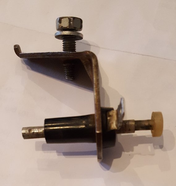

Brake light switch - clean/repair?
matthon
8:02 AM
Mar 3, 2018
1,619
1,481
New York
62-64, I have a few switches with the same symptoms.
Brake lights intermittent, if I spin the center of the switch it sounds a little crusty, plug it back in lights work.
Eventually brake lights are back to intermittent, and when they do work feed wire connector seems a little warm while lights are on.
Wiring is all new, modern fuse box etc.
If I connect the 2 wires brake lights come on no problem.
Getting a new correct switch is impossible, and new electrical parts are garbage anyway.
Nos ones pop up, but I just think the switch I have needs a good cleaning.
There's no removing it from the bracket without breaking the plastic.
Can these be taken apart to inspect and clean to return to service?
I cleaned mine with an ultrasonic cleaner but if you don't have access to one use some electrical contact cleaner.
