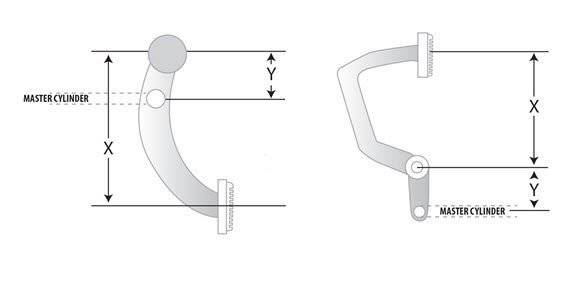

I think when I measured mine it was 6:1. Not my images..
https://techtalk.mpbrakes.com/how-to-series/correctly-calculating-pedal-ratio
Pedal Ratio = X divided by Y
