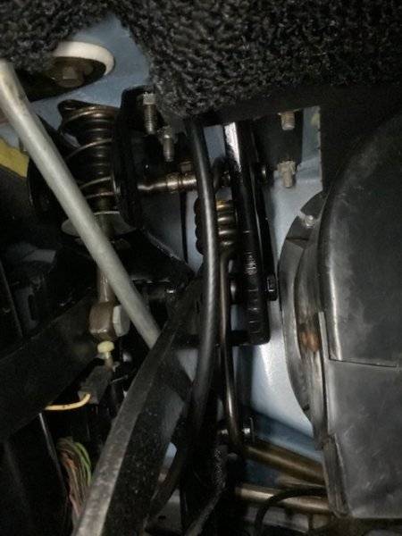

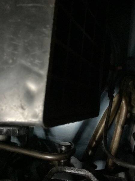

Well, I apologize for the the poor quality...just not an easy thing to photograph.
My 66 Coronet 500...no power brakes, but that shouldn't matter.
I hope this is some help
Looks like a clutch pedal over center spring to me.
yeah
I screwed up
I'll snap another pic tomorrow
there isa spring on the brake pedal linkage , but its more for anti rattle than anythign else
Yes a fairly wimpy spring that goes up/down from the linkage
There was a spring on the pedal assembly I just don't know yet how it goes on guess I will have to wait until I put the coronet back together
