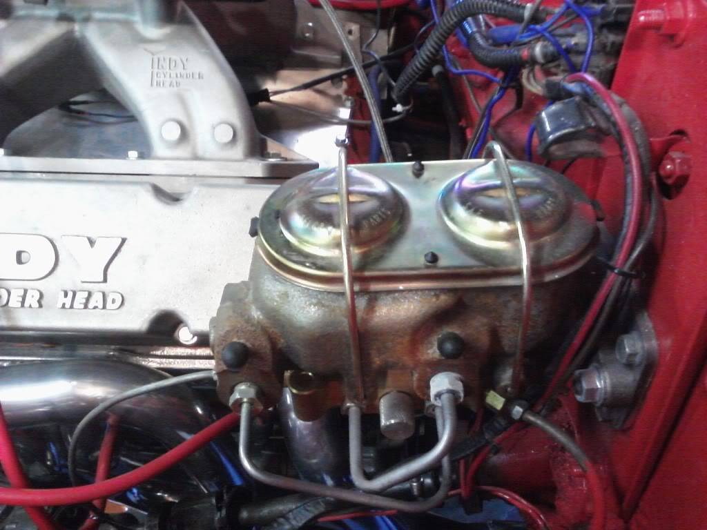

Don't know if this will help but I also switched to front disc on my 65 Coronet. I used the Jeg's kit. I replaced my master cylinder with a Master Power Brakes master cylinder conversion kit and their prop valve. Their add can be found in any Mopar mag. I need to paint it.
Nice set-up there Wedge5. Something I'll consider when I switch to disc brakes. Did you make your lines or were(at least some of them) part of the kit?
Nice background engine **** as well.:yes::yes::yes:

The lines from the prop valve to M/C came with it. I just had to finesse the stock lines to the prob valve(easy). The prop valve kit came with alot of different connections.
