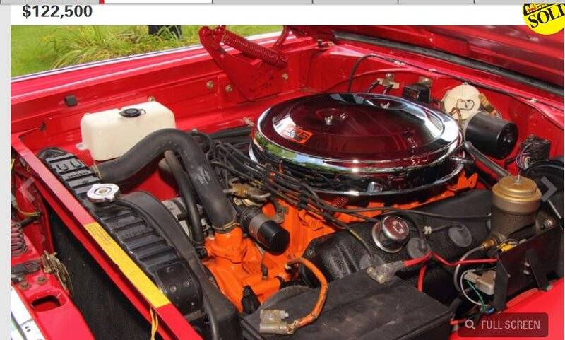

A picture of a 66 master cylinder, you'll need to enlarge a bit.
How do I tell if it's a dual or single MC?
When you take the cap off
look if you have a single reservoir or a double
Double Masters were made standard in 1967
cars before 67 had singles
after had doubles
Double is much safer as if you have a wheel cylinder go out you dont lose brakes for all four wheels
you still have the fronts or the rears depending on where the wheel cylinder failed at
