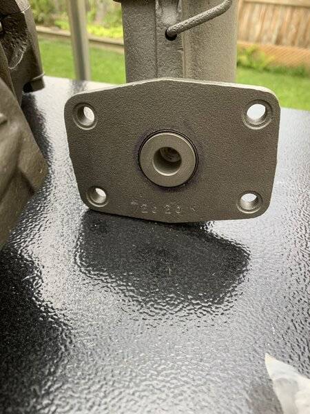

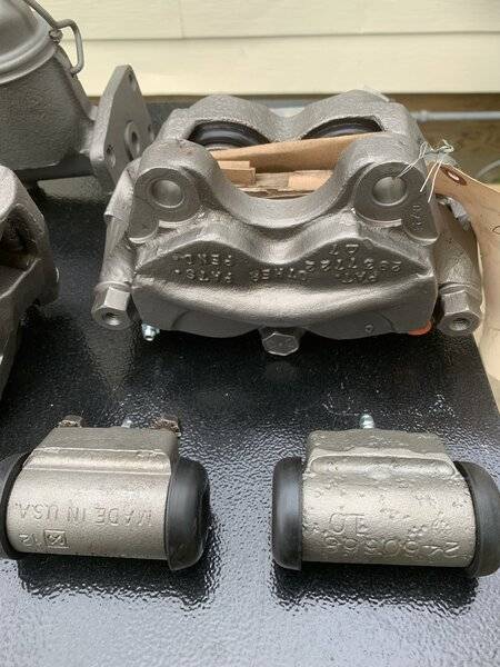

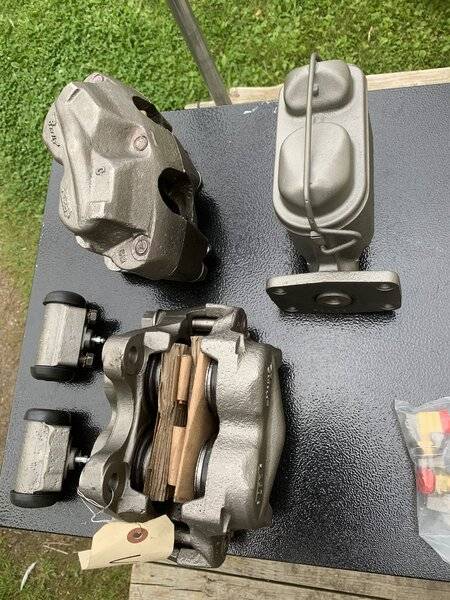

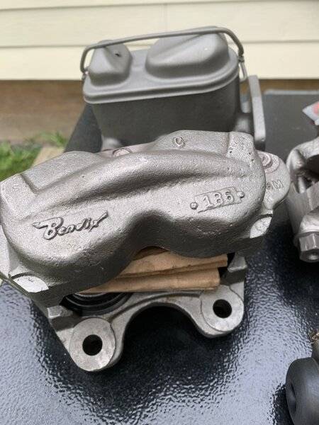

I’d be interested in getting my original shoes reclined for my GTX. I just had all the hydraulics stainless sleeved with the original parts. It’s a Hemi four speed car with 10x 2 1/2. I believe them to be original. Front discs.
