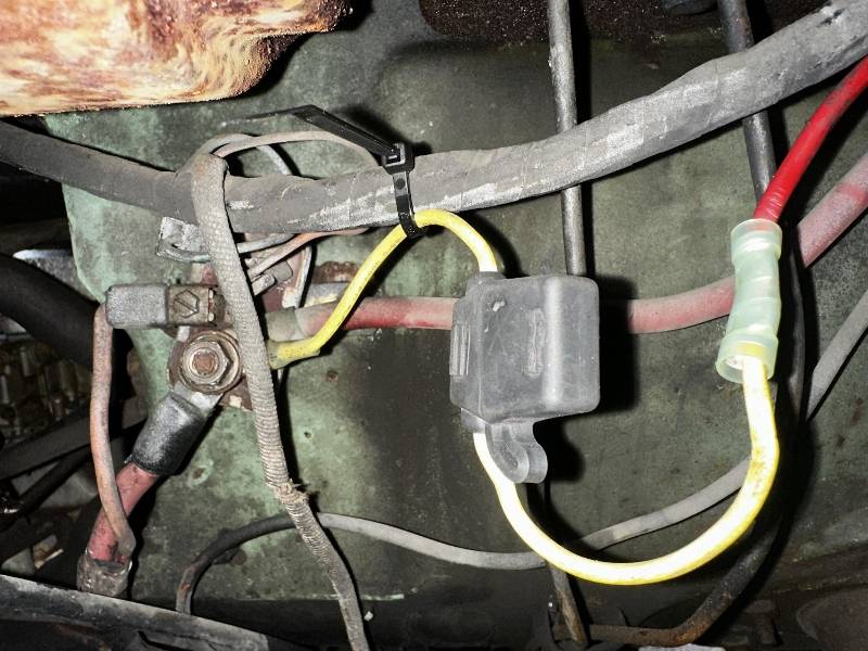

I replaced the turn signal cam in my '73 Kary Van, and took some extra time to look around at the condition of things. Like a fool I didn't disconnect the battery cable and accidentally bumped the pin connector with a screwdriver. That melted a fusible link up under the hood (second pic).
I replaced that wiring and added an inline fuse, but I'm getting no brake lights or turn signal. This could be from something in the connections in the steering column ( I had to solder in the new cam), and I was separately trying to free up the sticky brake pedal and may have messed something up in the brake switch wiring, but I'm not getting dash lights or hazard either.

I’d start at the fuse box since you shorted out the system and popped the main fusible link.
Thanks. The fuses looked fine but there is a melted terminal (heater slot) from looks like decades ago. I'm making a separate post about replacing that with a universal fuse block.

I’d still check power in and out of the fuse box. Gives a good starting point on which direction needs troubleshooting.
