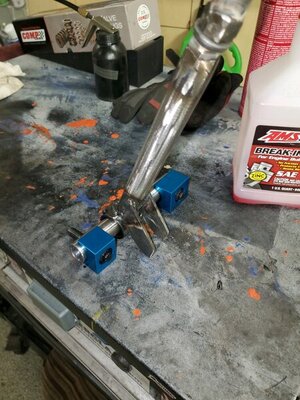

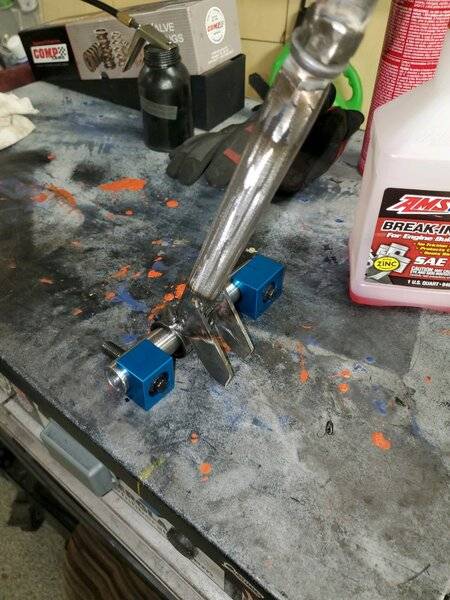

yes removing the springs can be tedious but if you have a nice tool you can do the job in less then a 6 pack.
i made my own tool from scrap cuz im cheap, took me about 2 beers.
