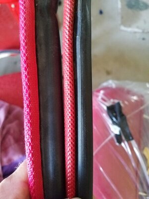

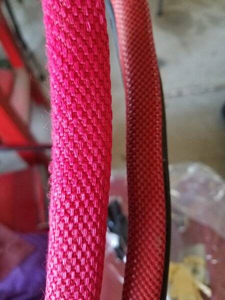

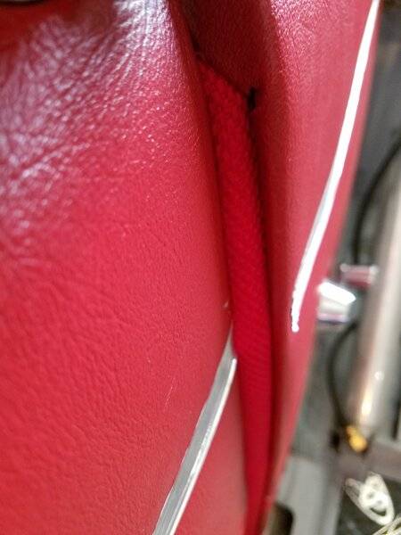

I couldn't find these seals that were anywhere close to OEM dim's and had installed ones I ordered letting them sit a couple weeks during car resto chores. I had a feeling this wouldn't work and it didn't. Ended up having to replace left door latch as the intense pressure damaged it. My supplier said he doesn't know of any mfg's that make them different! Some have made some fab mods to their cars to get them to fit; but this didn't appeal to me. My old seals were still in usable shape so put them back on. As photos show, ridiculously larger and no way to run them under the sill plate. If anyone knows of a source for these that actually fit - great to hear.

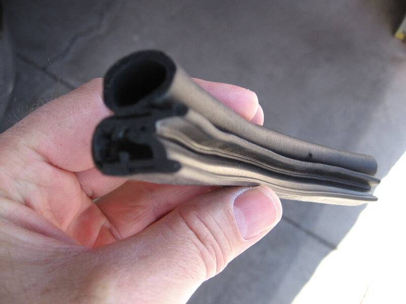

I was doing a 64 Dart a few years ago. I wasn't **** in being correct but functional .I bought a set of seals for my 88 Dodge Ram on rock auto. $19 for both doors. I got to looking at them and darn if they were perfect for the Dart. For that price I bought 6 sets enough for the Ram,Dart and my 63 Belvedere 4 door,put the rest on the shelf for future projects.
