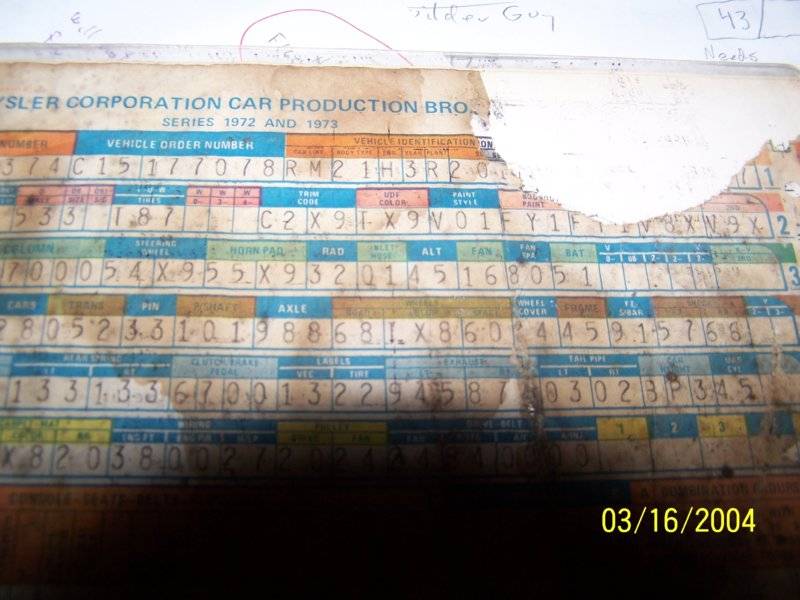

Having a little trouble with my 1973 RR wheels. I can't seem to find the exact answer on the net. I have the sheet and it shows under the WHEELS section:
Road-Code 68
Color-Code TX8
Spare- Code 60
Under the Wheel Cover section: either 14 or T4 (little worn there)
Any help would be great.
If I am not mistaken, the code is the last of the part #
Road Code 3580068: 73-74 B body 14x6.0 Rally Wheel Class 1
Color Code TX8: Black
Spare Code 3580060: 72-74 B body 14x6.0 Stamped Steel
Wheel Cover 2944424: 70-74 A-B-E body Class 1 & 2 14" Trim Ring-Less Lip
