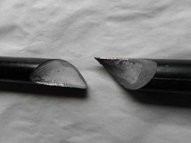

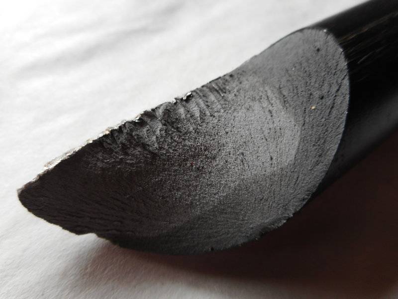

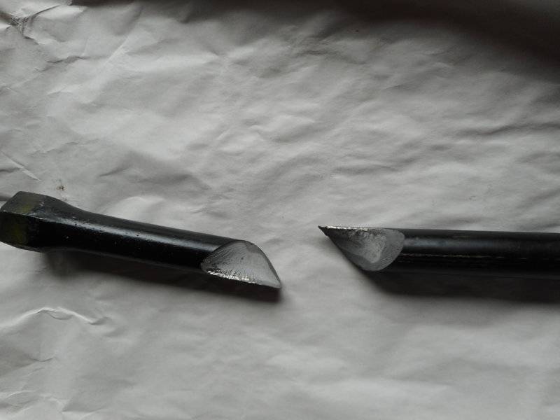

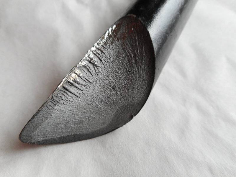

I plan to remove the bar today and I will post pics.
The fracture line I can see is all grey - indicating OK one minute and a sudden fracture.

You can see from the shiny part there must have been a fine crack and then it broke.
Hope the new ones are OK.
Black and white pictures ? ? ? Are you trying to be classy or something ??
No they are digital colour I just put some wrapping paper under it to try and highlight the break so it can be seen better.
The fracture is grey the pic is pretty accurate to how it looks to your eye.
I guess a sense of humor is a rare thing nowadays.
