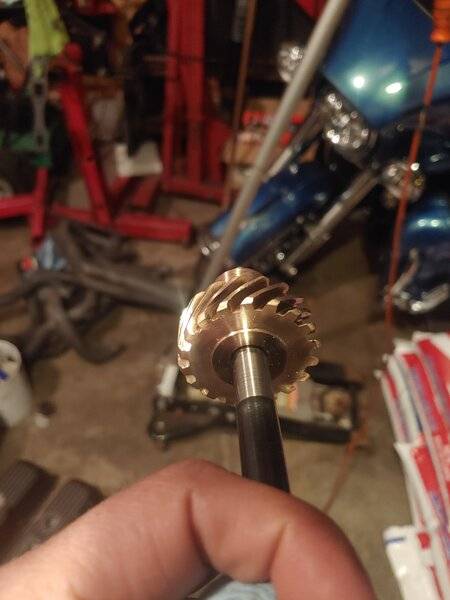

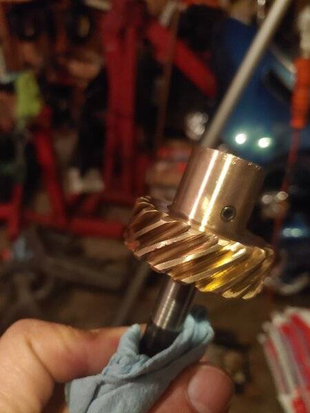

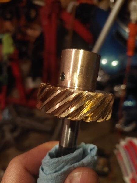

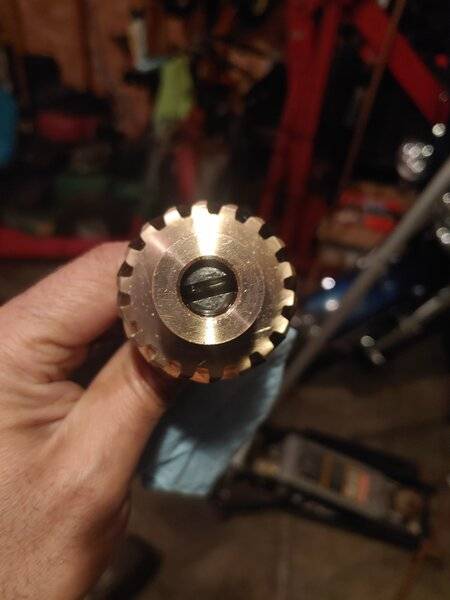

I’m looking for alternatives to bronze, so far I’ve only found the Hughes option, who has/sells composite gears???
