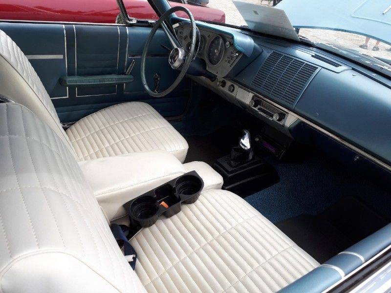

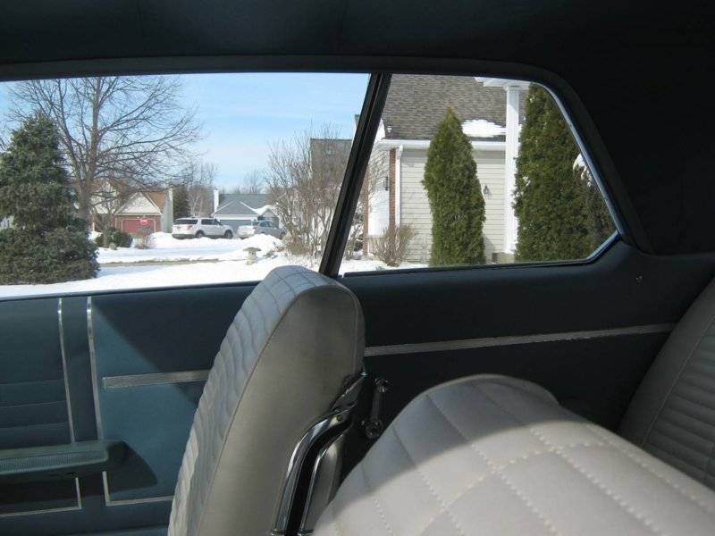

Any 62-65 will bolt in. So don’t limit your search.

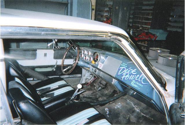

When I went searching for buckets, my deal was something that would be sized - all about wide enough - to look right in my car. Seats are easily found at meets and such (web) but routinely were much narrower than the old B-body seats. Heck my Dakota seats aren't as wide at 21 inches and the era buckets are 24-inches (seat pan). I found a set of correct seats for my '63. Then ya got the seat bracketing to confront if getting away from stock. With your car being tubed you might need narrower seats anyway. A few I had come across that seemed almost a pick were from mini-vans and smaller pickups as I recollect (its been some years since I was on the hunt). Larger car seats were also in the ballpark as I remember sifting thru tons of them at swap meets. Matter of what your preference is for appearance and performance on the track I imagine.
and i found early a bodies buckets can be modified to fit the floor , same uppers .

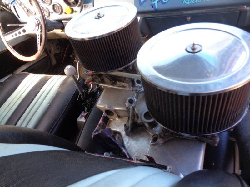

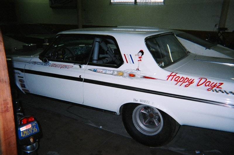

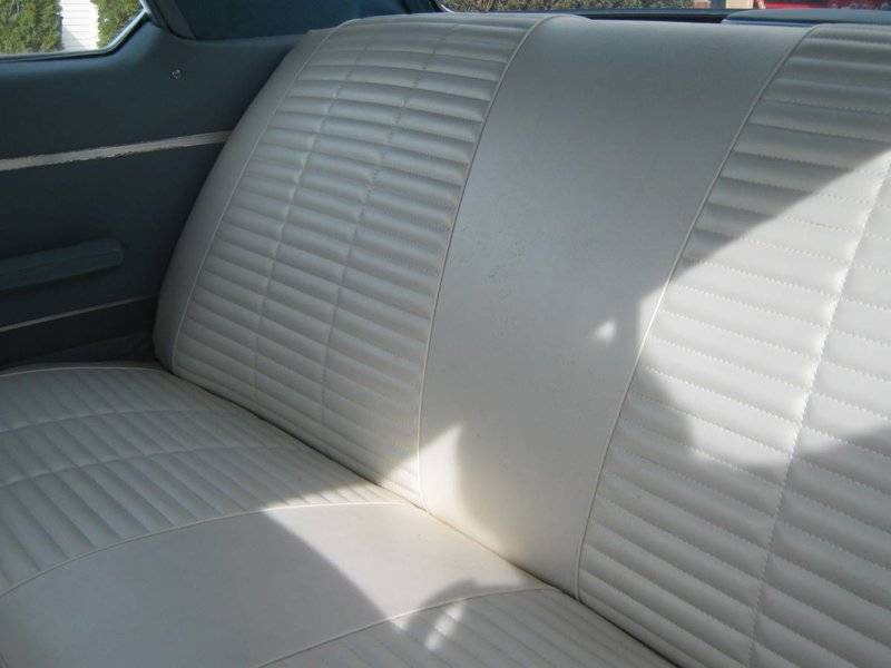

My '63 Fury ..think they were out of 66/67 Coronet ??

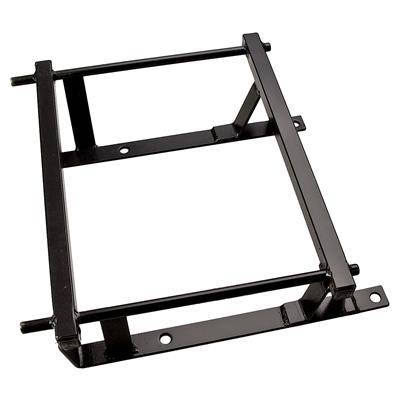

I used ProCar/Scat 1100 Elites #51 in black with adj. backs & headrests
(got mine back in 2007-ish Jeggs, about $750 total with opt. mounts)
bolted right in with the slide tracks, opt. supplied & mounts
my car had a bench seat
so I had to drill for the inside seat bolts by the tunnel
easy deal
I chose them for a little more headroom (thinner seat base)
& a classic car look, lighter than the org bench seat too
really comfortable
they have more to choose from too

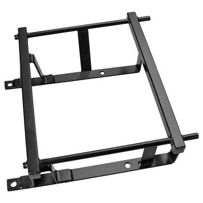

Pro Car Seat Adapdter Brackets Driver side SCA-81342 $77.95 Dodge Plymouth.jpg
