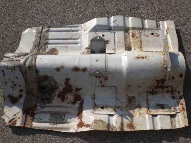

Need guidance on where to locate and secure (bolt or weld) 2 mounts which hold down the buddy seat for my 67 GTX.
These are on the hump between bucket seats
Are dimensions or instructions available for locating these 2 mounts?
Appreciate any information you may be able to provide.
Thanks
this is all I have from my thread,I need them also
Thanks much for the photo which shows references
This is helpful.
I'll leave the posting open to see what other information comes in.
All that is really needed is the location for one of the brackets.
The other bracket can then be located by bolting both the brackets to the buddy seat itself
Again, thanks
There should be dimples and flat spots on the floor pan.
Hard not to see where the brackets go.
You'd almost have to make a conscious effort to get it wrong.
the 1 bracket looks like it is even with the rib of the floor.
