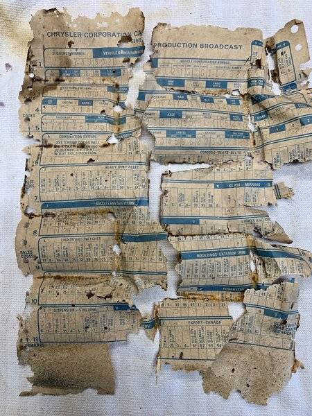

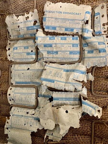

Found this underneath the back bench seat. All the numbers for options match identically except for the sequence number. Do you think the factory put this seat in the wrong Belvedere? Shouldn’t the sequential number match the last vin numbers?

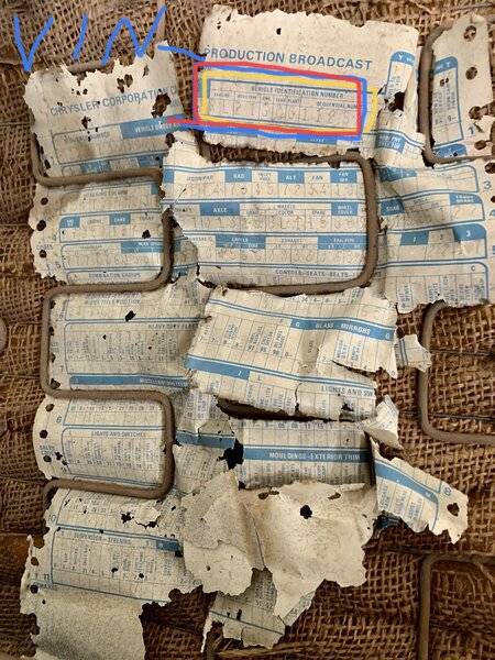

Your VIN should match the info in the "Vehicle Identification Number" boxes/fields, starting on the first line, near the center. The first "field", under the heading "Sequence Number" is different than the last numbers of your VIN. Confused?
Somebody else can explain the difference between the Sequence Number and Sequential Number on your build sheets.
The VIN # should match the VIN# not the sequence #.. look to the right, top line.
Right, under sequential number. Those numbers are not in my vin number.
No, the first number is a sequential # as the cars where scheduled to go down the line. Further over in the middle is the VIN # under where it says Vehicle Identification Number. It should match your VIN, but if not wouldn't be surprised as guys grabbed for black seats and threw them into cars

The VIN number is right under where it’s printed “production broadcast“.
Is that your vin number on the sheet?
the sequence number on the top right is not in your vin or on the car.

Dude, if you zoom in under vehicle identification number, there’s a heading that says sequential number. The number is under that, at the center of the top of the page, should match my Vin number and they do not.
That is under the VIn heading and so it’s different so not your car.

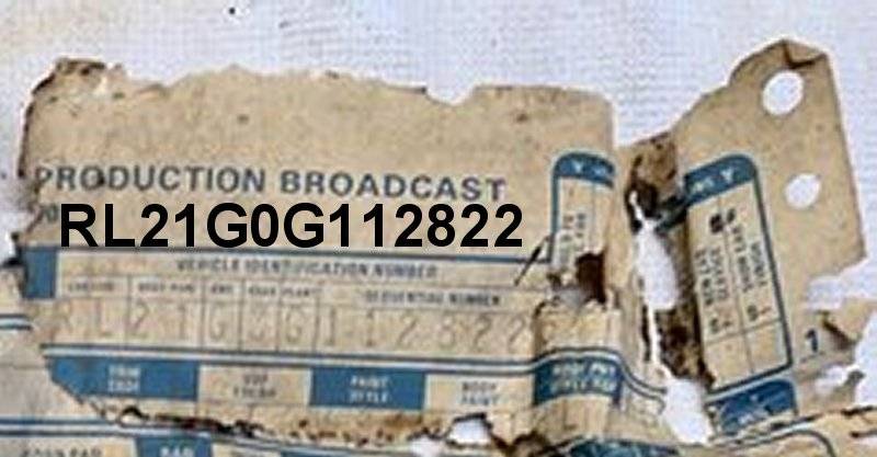

The 1128226 is not in my VIN. The RL21GOG is. So not original to my car?
On the dash VIN tag, what are the 6 digits after the RL21G0G?
I cannot read your broadcast sheet so I need you to tell me the answer to the question above.
