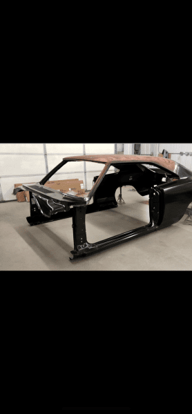

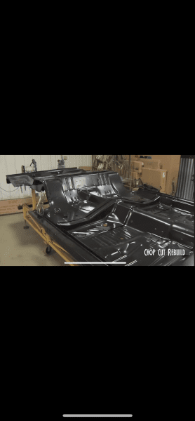

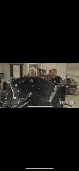

Im building 70 charger with AMD panels, judge me if you want. But i just got a jig welded up and im going to attempt it. I have the whole front end body panels & all specific ‘70 parts that arent remade. Great shape too. Took alot of time to aquire them. I was wondering whats the best approach to begin this. By starting from the framerails, then floors, and up from there as so in picture 1 & 2? OR use the jig support and start crafting the shell front the rockers & up, and from the front firewall to the rear valance, then put floors in and framerails/chassis shown in picture 3! And yes, it is going to take lots of time and money. I will take as much time it takes until its DONE! Ive been planning this since 7th grade. Im 22 now.

don't weld anything until everything is positioned properly and screwed together........ moving a screw 1/8 of an inch is way easier than undoing a weld
let the outer sheet metal be your guide, it doesn't lie

You have the advantage right now, before it gets all put together. Judging from your other post where you indicated a desire to have good handling as well as high power, you're going to want to build the car stronger than Dodge originally did. Check into aftermarket items such as sub frame connectors, inner fender braces, and a roll cage.
If you are serious about not having a cost issue then it's a matter of careful research and time spent. You said you wanted a 600" Noonan engine, aren't they around $13,000 just for the bare block? I'd contact them for advice on engine set-back and type of exhaust in case you have to modify the engine bay for it, as well as deciding what transmission you'll use because some of them need tunnel mods as well.
