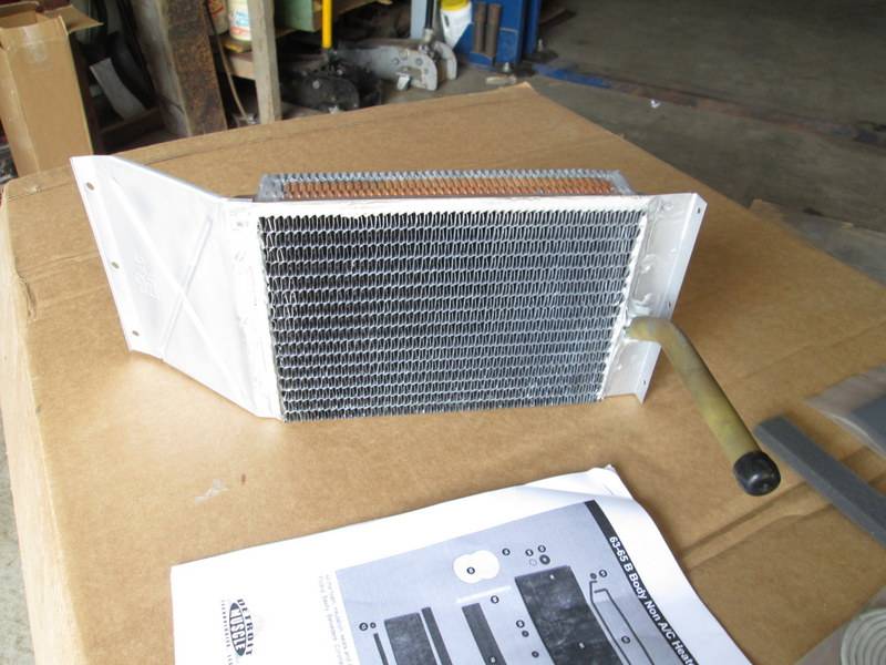

- as another stated you will have to plug both ends,or easy way make a short loop if its temporary, any radiator shop can repair the core if its not completely deteriorated. many new heater cores available on ebay among other places. I usually put about1/2pint soluble oil on the radiator, it is used to cool parts while machine and prevents rust. with a new system you wont get a rusty block and radiator core.
I bought a NEW heater core for mine I believe from Napa. I think it cost me around $75.00. The real cost will be the labor involved to change it out. Accessing from under dash and disconnecting defroster vents, cables, etc...., might have to remove the instrument cluster first and then the box itself. Some things are not a walk in the park to reach.
Thanks for all the input. I live in south Florida and can't remember when I've used the heater in a car or house. So if it's a lot of work I might just keep it bypassed. I just want to drive it it's been sitting in my Dad's garage for 24 years.

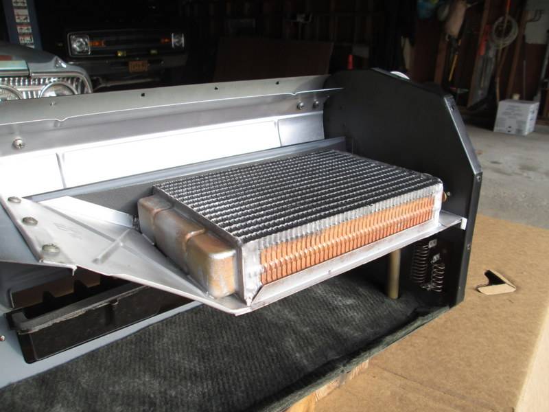

Mine has been bypassed for nearly 15 years. haha. Came out senior year to a passenger floorboard full of radiator fluid. I just rebuilt my heater box with all new material from http://detroitmuscletechnologies.com (awesome site btw). I decided not to spend the extra 100+ bucks on a new heater core since i'll eventually do A/C and replace the box completely.

If you buy one make sure tubes coming though firewall are the same length as old one. Bought new core installed in car oops, couldn't attach hoses. Pipes 1/2 inch out of fw. they had to put old tank on new core.
